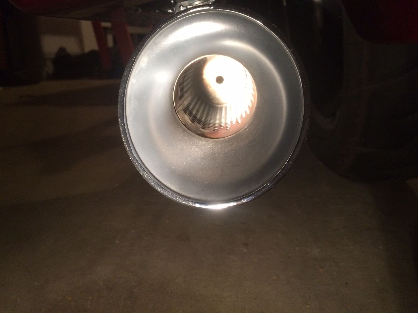

I was told if you remove the washer then you have the normal crushers.

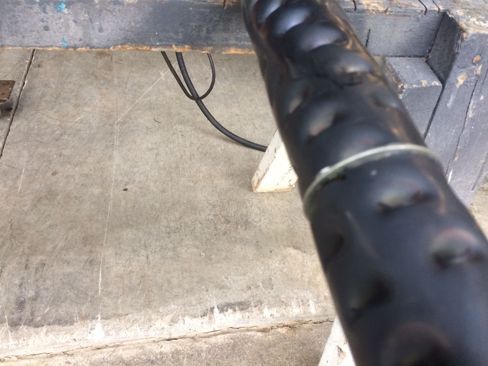

First of all thanks to Idahokid for the Mellow baffle photo!
After replacing the Fullsac blankets in the CVO's the noise was still much louder than what I wanted.

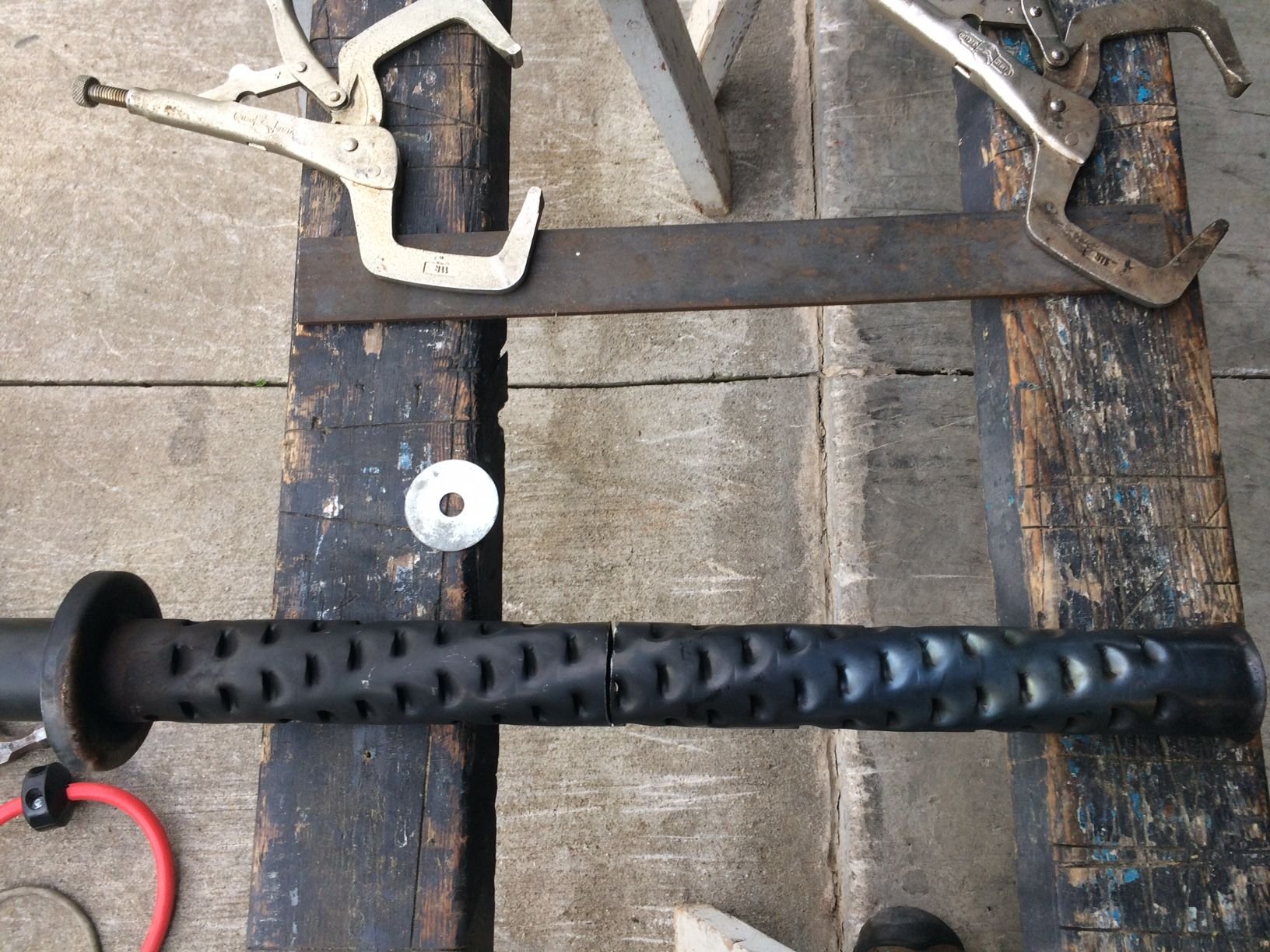

Tonight I pulled the 2" Fullsac baffles out again and decided to weld in a washer similar to what the Crusher Mellows have. To do this I found 2- 2" OD washers in my shop. They only had a 1/2" hole in them but looking at the Mellow photo that Idahokid posted it was hard to tell but sure looked like it could be a 1/2" (this fact is an unknown to me).
I clamped the baffles in my bandsaw and cut them about 3/4 of the way through the diameter. I set the cut at 9" from the rear of the baffle. After cutting them I used a thin cut off wheel to match the cut to the thickness of the washers. I then clamped the baffles to a piece of steel using a couple pairs of vise grip clamps. This kept the baffles straight and true as I welded them back solidly.
Reinstalled the baffles and they sound deeper and quieter than with the straight through core. The annoying higher pitched is gone. Went out for a short spin and they were much quieter and easier on my ears. When I got back I decided to fab up a 16" long 13/16" drill bit so I could increase the size of the hole in the washer. Sounds even better now and still has a very very deep tone with no tinny sound what so ever. I'm going to try a put on a couple hundred miles with them in the next day or two. Will also run a couple of Auto Tune sessions to compensate for the increased back pressure.
I'm pretty sure I'm finally close to where I want to sound level to be. I can always increase the hole size of the washers if I feel the need. At this point I'm guessing that I won't need to do that.
The sound is deeper, a little louder, and less tinny, than what it was when I tested the TD's with my stock OEM SG mufflers. Also sounds absolutely fantastic to me at an idle. No more of that poof poof restricted sound when idling.
I'm not saying, or guessing that this baffle mod will reduce or increase overall performance, I consider the SGS to be an 830 lb cruiser, not a drag bike. Hopefully this will help make an all day ride more enjoyable for me and my tired old ears. I love the looks of my CVO cans and hope to like the Mellow/Fullsac modded baffles as well.
