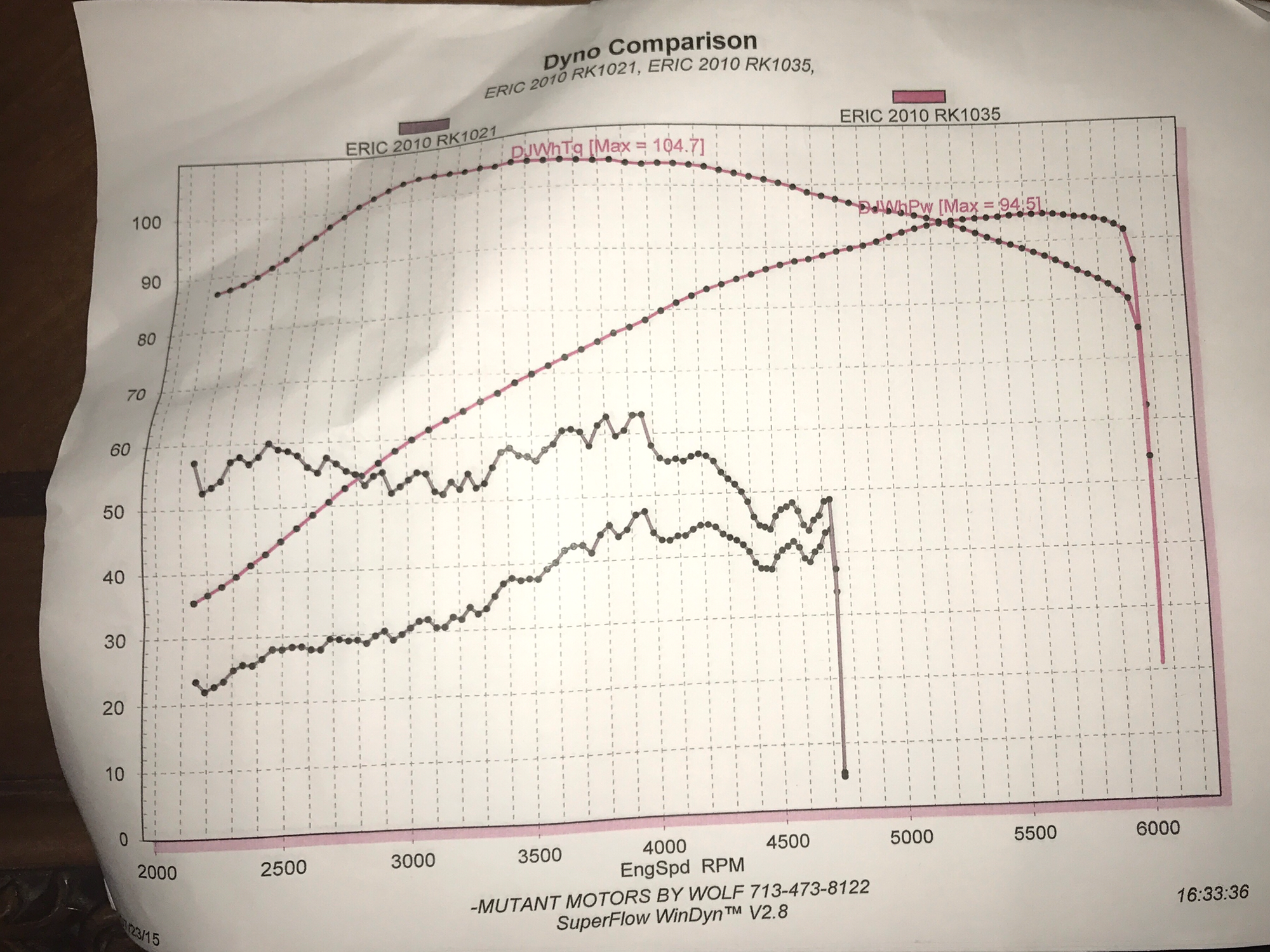

I put the Andrews 48 in my 96. A scenario where this cam shines, two Lane road, 65 mph, 6th gear, feet on the highway pegs. Come up to a truck hauling scrap metal, you want to pass, roll the throttle and fly by, no hesitation, no downshifting. It quickly climbs past 100 mph.
