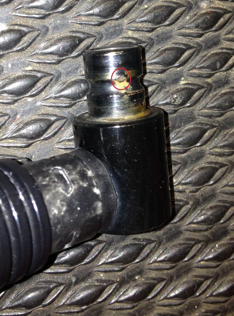

Check the "L" shaped fitting on the fuel line, where it goes into the tank, for wear in the groove from the 3 check ***** in the quick release valve. If you have wear then the line can pull far enough away to close the one way valve and shut the fuel off. It happened to me riding down the road and had to get it towed home. Harley has a different fuel line for it now.
