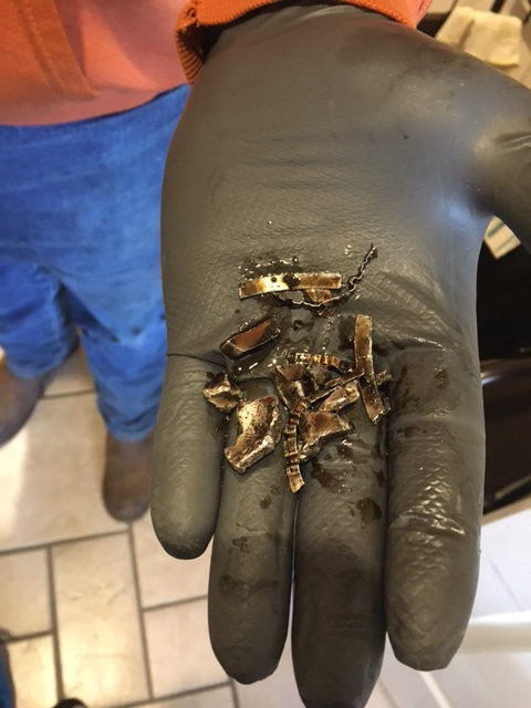

When I pulled the throttle body off, this debris fell out of the front cylinder side.
So it was no great surprise when I found this inside.
Taking a little break to watch my daughter cheer at a football game. More to come.

Wow change my vote to replacement

Wow! A mess is an understatement! How does the head look? Time to split the case and see if it's salvageable. You leaning toward the S&S or a used 103?

Whole thing is junk, with that much debris flying around, you'd be foolish to salvage anything in there. Go find a replacement .
