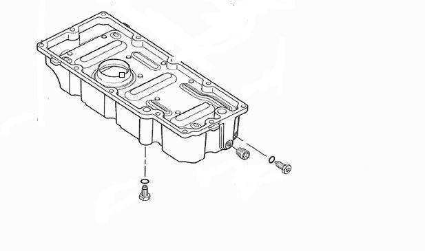

In the pic below, the oil drain plug is shown on the right (which will be on the left side of your bike underneath) and is horizontally situated. The one in the middle does not get removed. The one on the left of the pic, vertically situated (on the right of your bike) is the tranny drain plug
