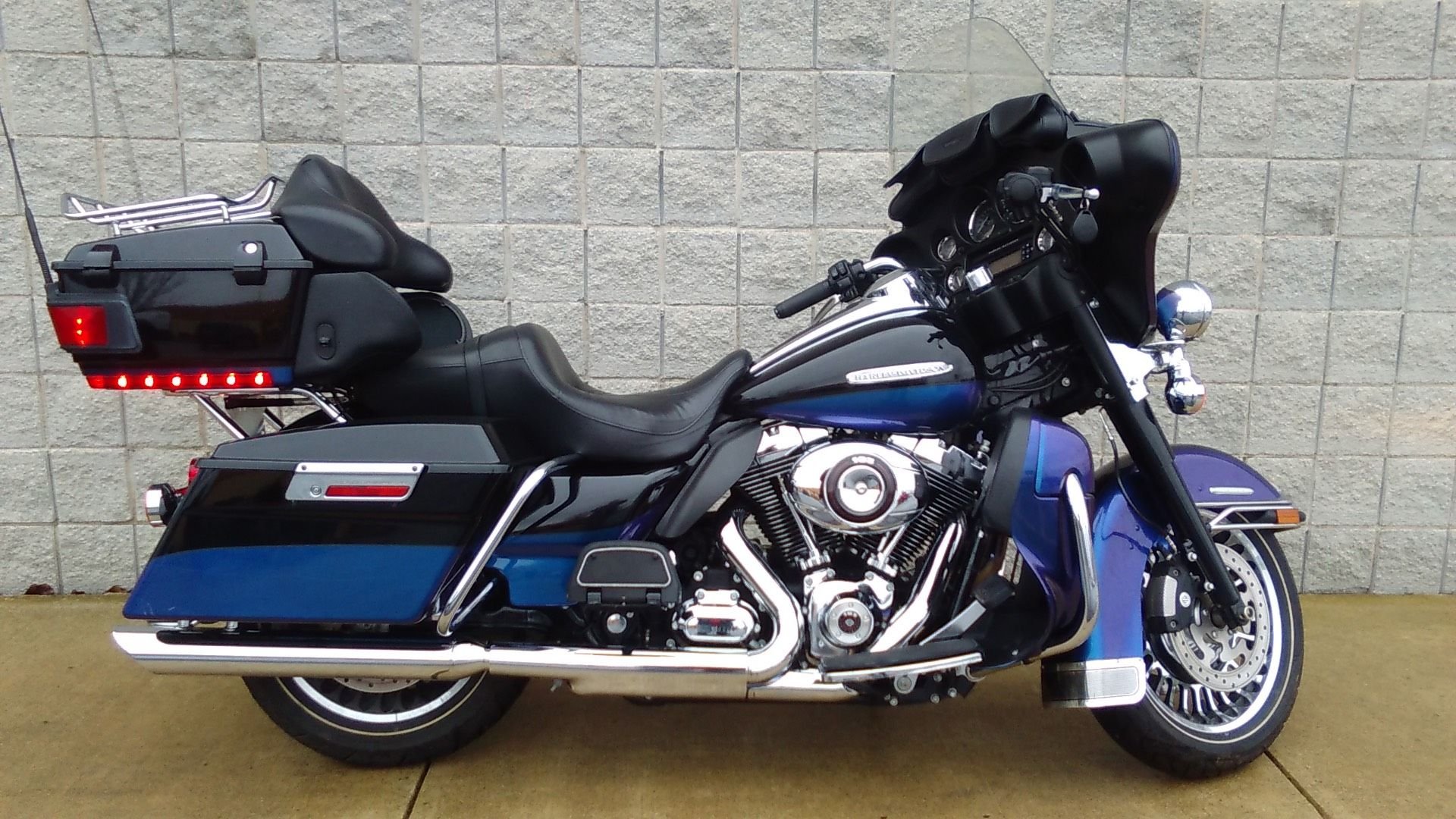

They were on the bike when I bought it and they are pretty loud. No baffles but I do see 2 bolt holes on the bottom where I can add baffles. Problem is I have have no clue as to what brand they are so I can buy the correct baffles. No stamps or part numbers on them. Any guesses are appreciated.

Rush maybe?
http://www.rushracingproducts.com/big%20louie.html

Not too sure if it's a Rush. The tapered side is too rounded for a Rush. From the pic, it also looks like the tapered end has a weld seam. Most top brands have a smooth taper with no seams or welds.

I'm leaning towards "Cycle Shack"

Those look like Rush. I have an older set of straight cuts with one bolt. Rush changed over to the two bolt baffle later on. You can order baffles and wrap from Rush Racing, or search for others that sell the baffles.

Rush uses the round stand off. Measure the ID of the muffler.

No weld. Just looks that way in the pic.

3.3195" ID, 3.4625" OD

Those are 3.5" cans. Rush, Wild Pig and other make baffles.
