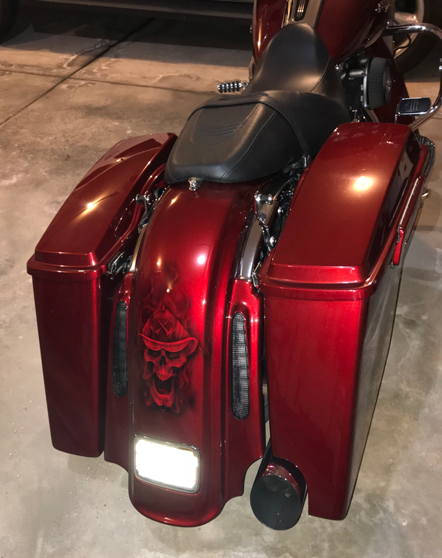

Photo's as promised. All done, love the way it turned out.

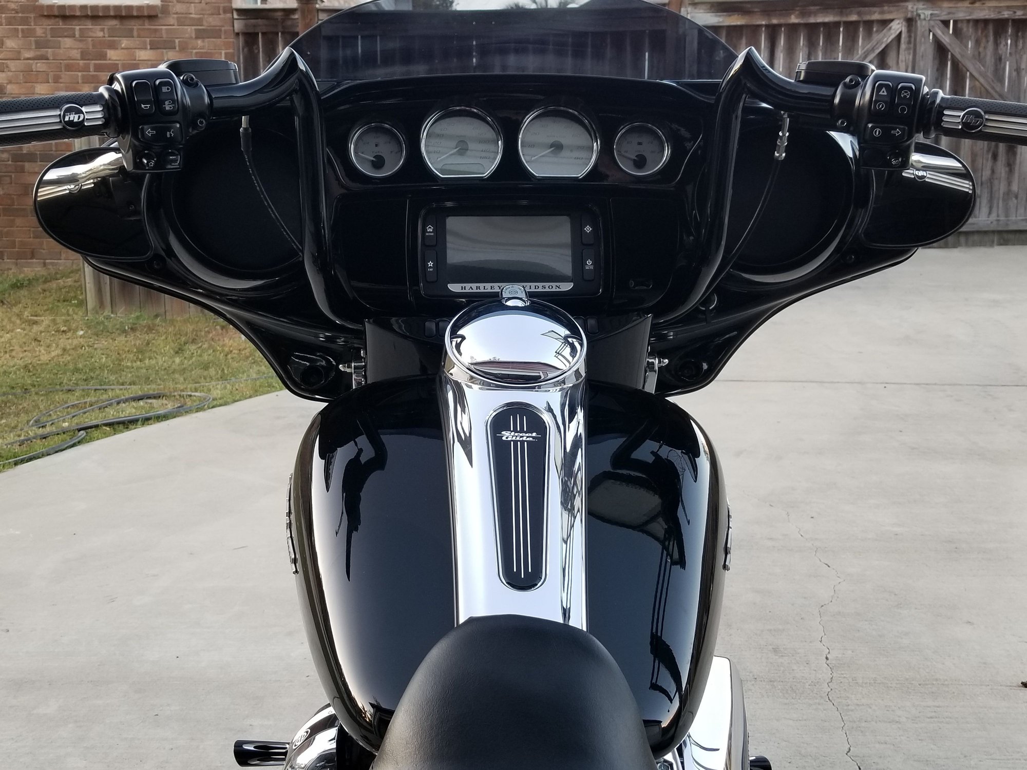

Side pic of the KST 12's
