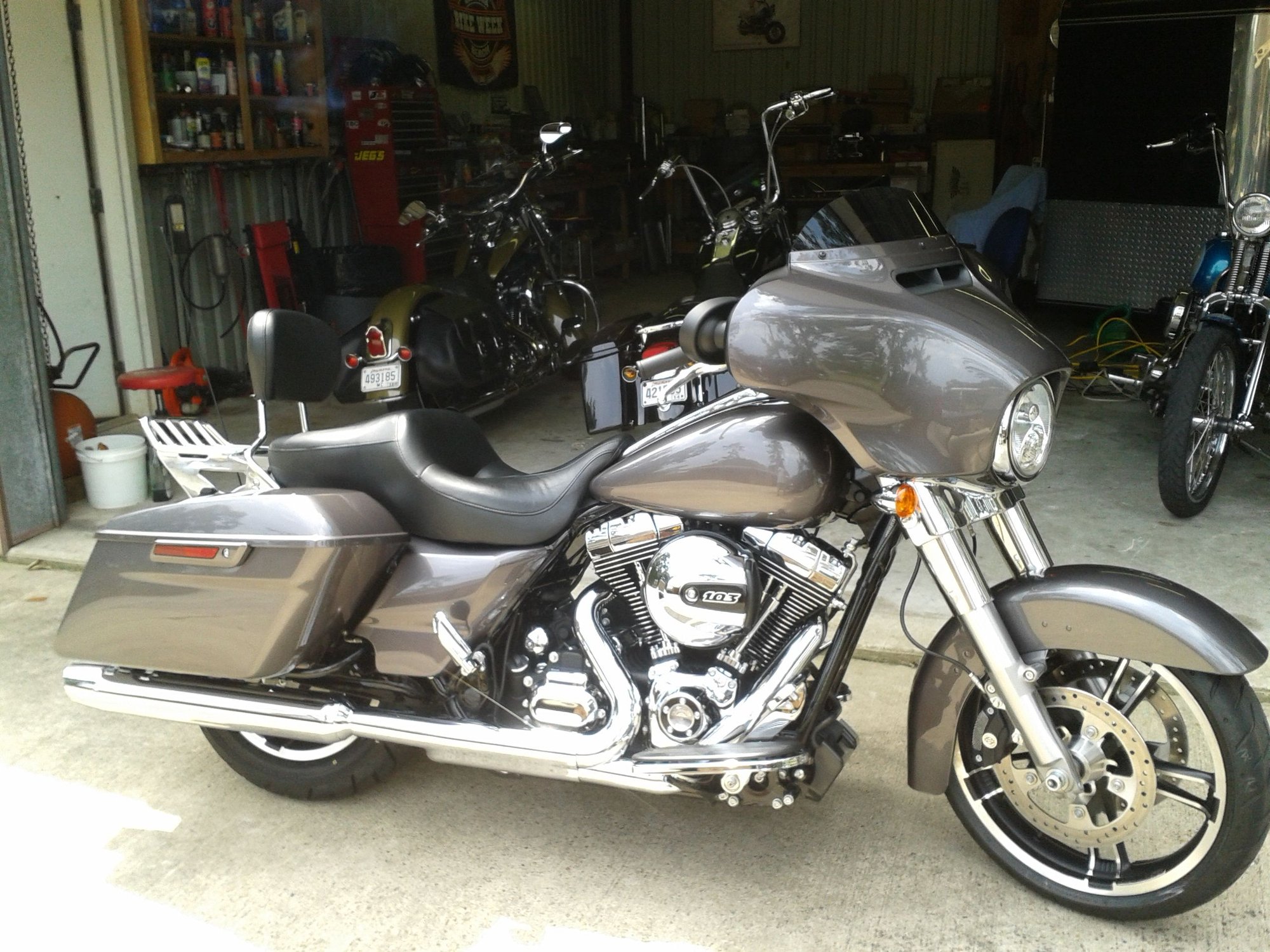

Cool whole bike ...
Yup...we've done it before and depending on the color ...just watch that nothing comes back "orange pealed" ...the gloss will show that much more than the semi-gloss...or flat ...
good luck ..

Thanks, guys! That’s all I needed to hear! I’ll start the pricing process tomorrow.
Springers4ever - your bike looks awesome!

......Springers4ever - your bike looks awesome!
Totally agree! 'Springers4ever' that is one hell of an impressive powder-coat transformation! Nice one!
