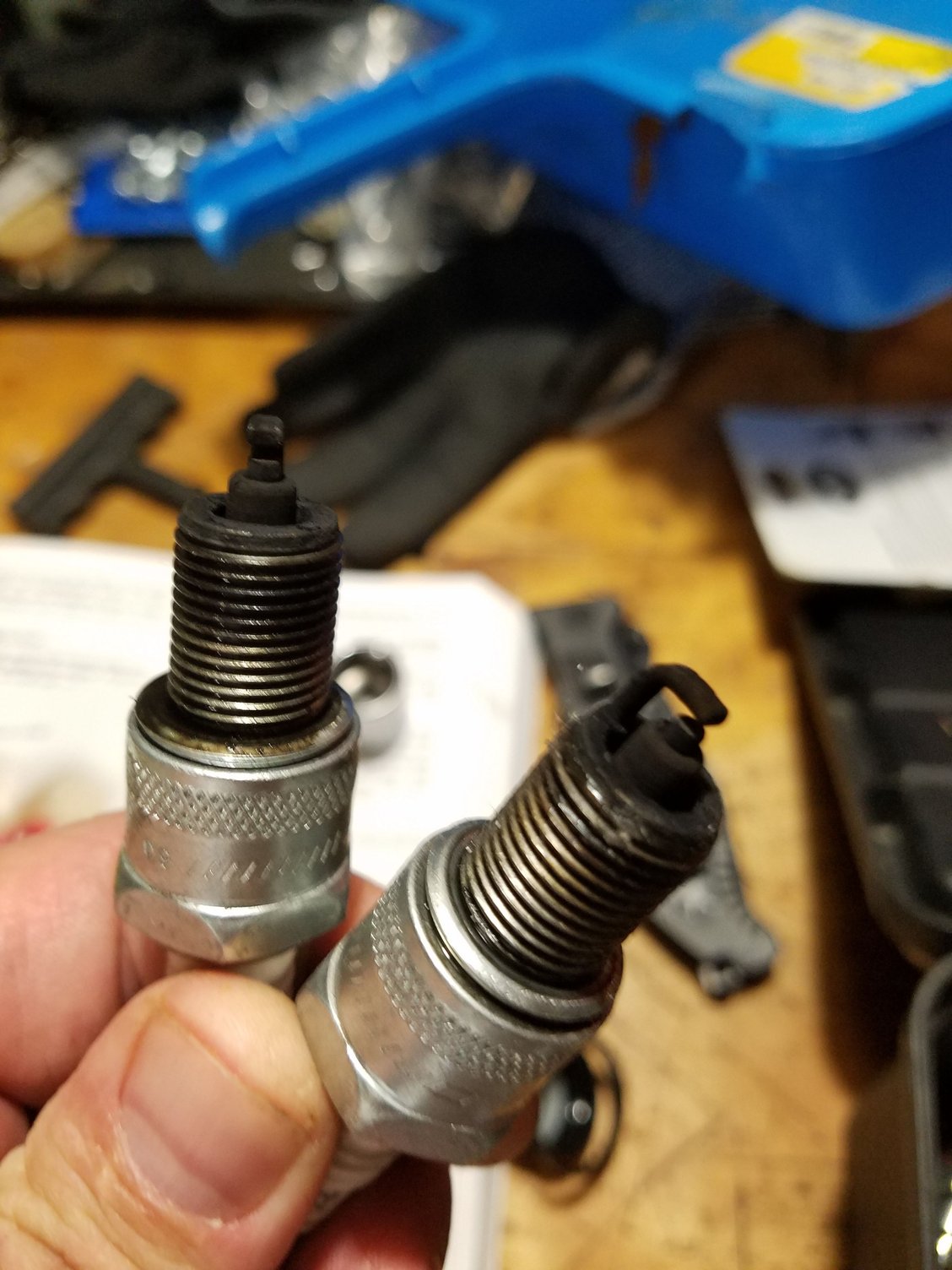

The plugs seem dark to me. I changed them new last sumer. The center diode seems not cream and sugar but not black, leather brown maybe. The air filter is k&n and it gets cleaned and resprayed with oil. (Not alot)

Old Mar 1, 2018 | 10:04 PM
Mhoffer's Avatar
Mhoffer
Joined: May 2017
Posts: 41
From: Reno, NV
Guess they are pretty dark

Too rich. Are you running a tuner?
