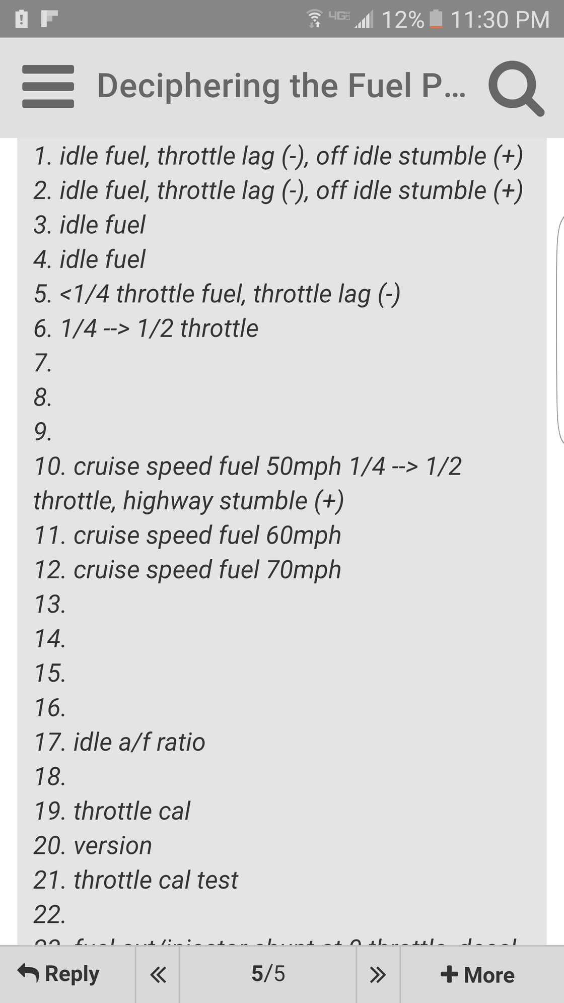

I had a fuel pak on my 08 road king ...for about 2 weeks lol. It ran better but I could get either the bottom end to run good or the top end..i could never get them both running great at the same time. If you email them and tell them your problems they will give you some changes to make in certain values. They're very secretive of what value controls what , I'll attach a little info that I have from when I was fighting the war lol. I can't remember which value it is but there is one for adjusting the fuel in the no throttle position...which will help with the popping. I highly recommend e-mailing v&h they will help you get it close. I just didn't have the patience to mess with it and I love working on my bike. But if want a third one I have a practically brand new one for an awesome price...just kidding good luck getting straightened out
