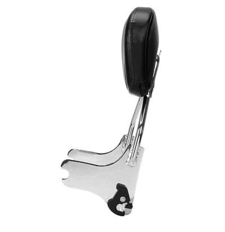

I'm installing a aftermarket detachable sissy bar.when I put pressure on it the front keeps coming up.not sure what I did wrong

Male sure you have those two half holes on the front clipped in or it will do as you're describing

I thought I did but I'll check to make sure.thank u

Make sure you have the correct docking kit. Although it doesn't say it fits the Ultra, that back rest looks like it would need the 53803-06 kit. https://www.harley-davidson.com/app-...nts_Matrix.pdf
