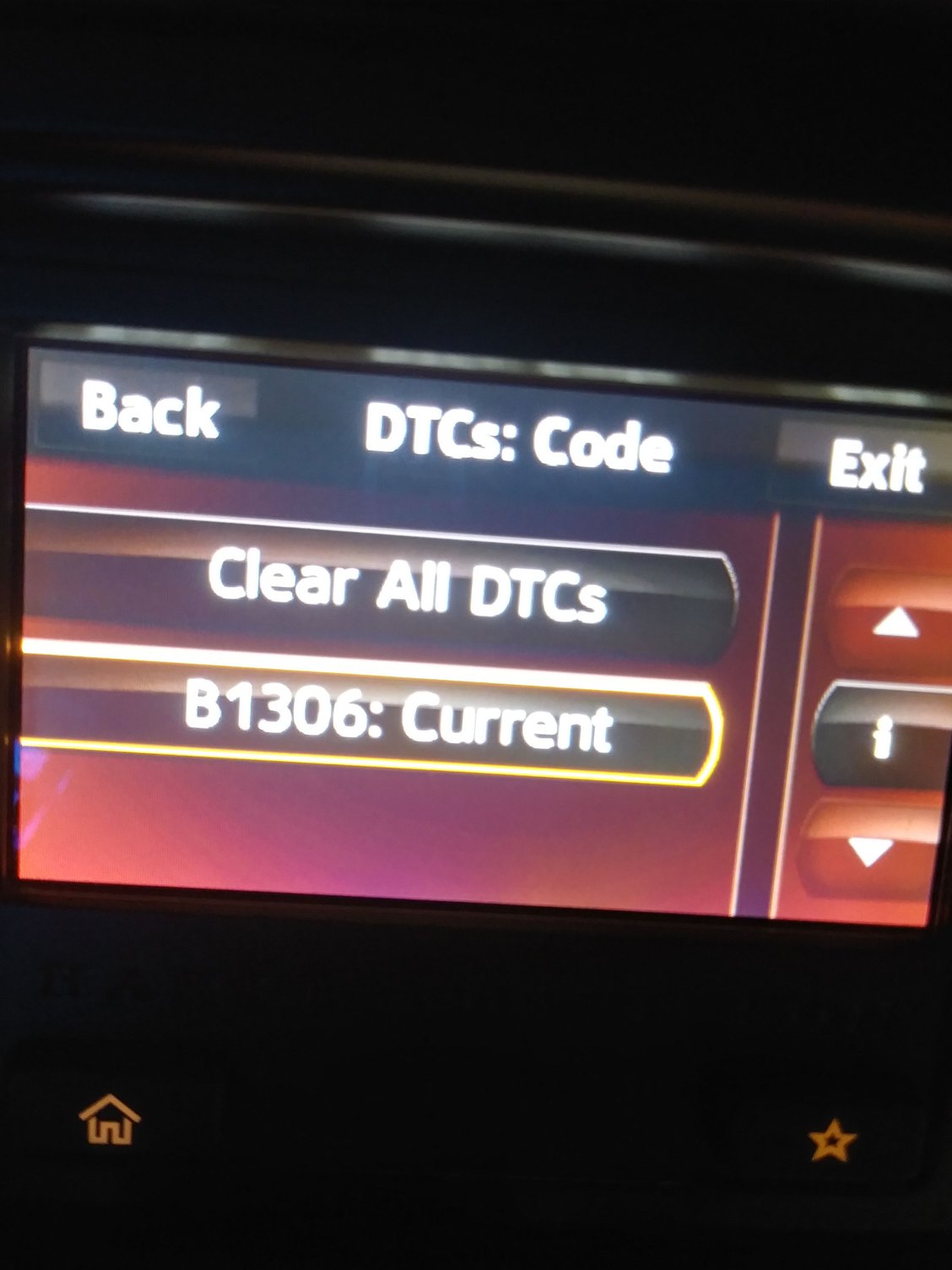

That being said Im having an issue.... I have a 2016 Street glide and had some work done too it but now I'm getting a dtc code B1306.i tried to Google the code but can't find it! Go figure..

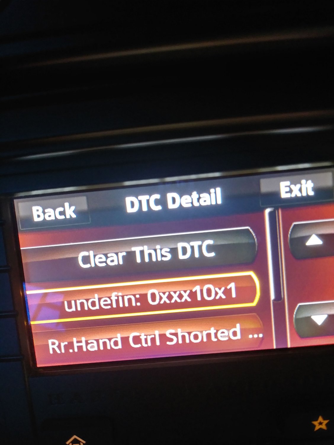

Like it shows in your second picture, it has to do with the controls on the right hand grip. Could be a short in the module or something. Do all of those controls work as intended? (Including the brake light switch and throttle). You can always clear the code to see if it comes back.

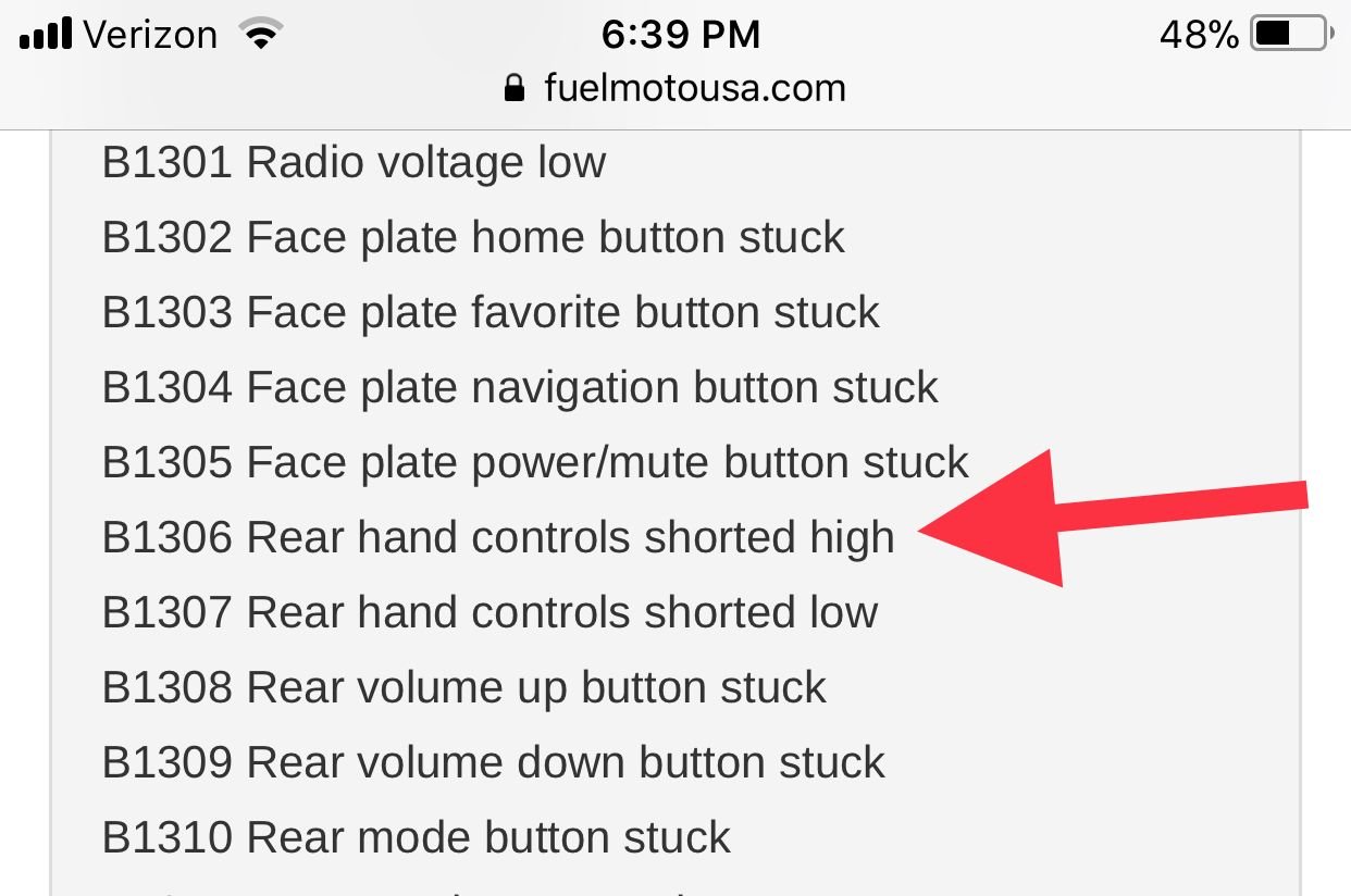

Also, for the codes, check out Fuel Moto. They have a section to all of the codes. I’ll link it below. Also a pic showing the B1306 code.
https://www.fuelmotousa.com/p-29661-...ble-codes.html

That says Rear not Right. It may have to due with the wiring for a tour pack I found this http://harleytechtalk.com/index.php?topic=99087.0

Yeah I saw that but wasn’t sure if there was a double meaning (as in rear brake control, rear signal control, etc).
Being that the OP specified Street Glide, I just figured there was no tour pack involved here.
