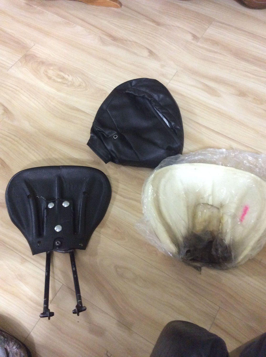

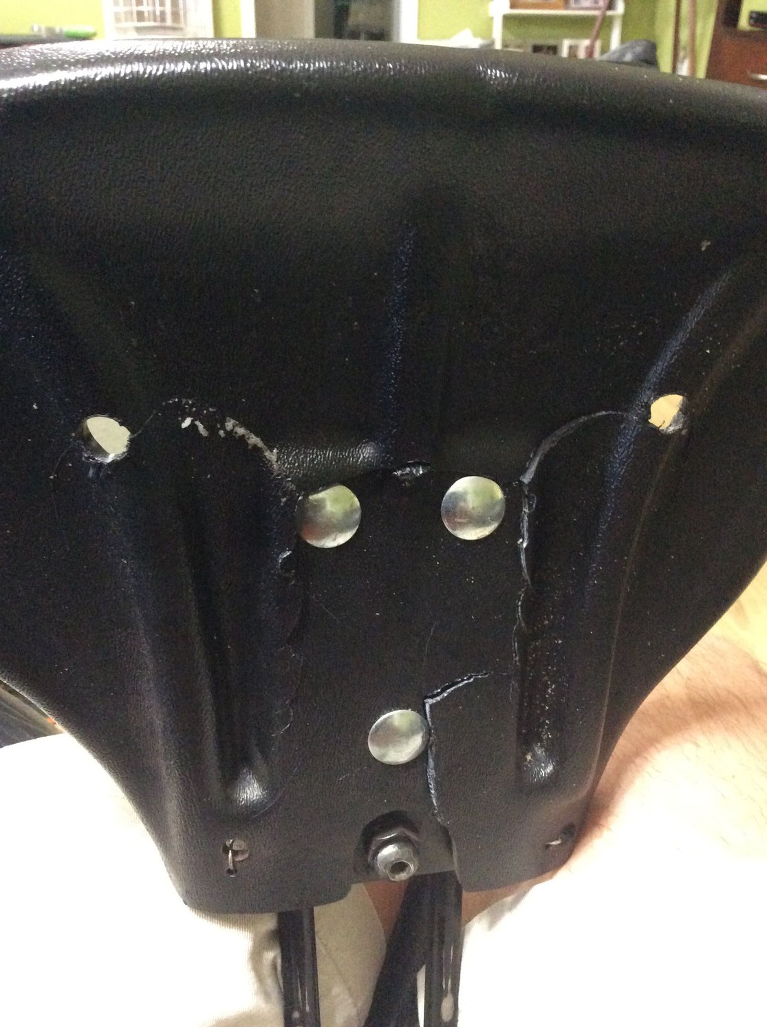

I have a rider backrest on my 07 FLHTC, the inside plastic molded shell broke and I am attempting to repair it

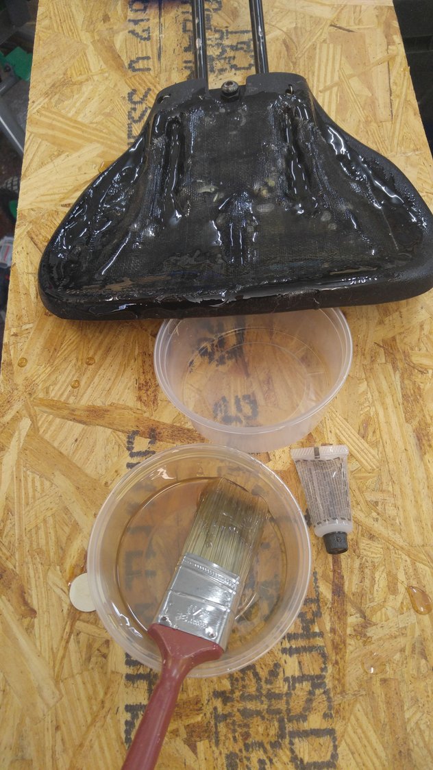

Pins, rods, plastic welding epoxy and/or fiber glass resin. I’m off to Lowe’s and Advance Auto.

Drilling a small hole at the end of the crack should stop it from growing any longer. Then reinforce as per your desire.

Thanks I’m gonna do that before I put the fiberglass resin an mesh, I’ve already put a coat of plastic welding epoxy on
