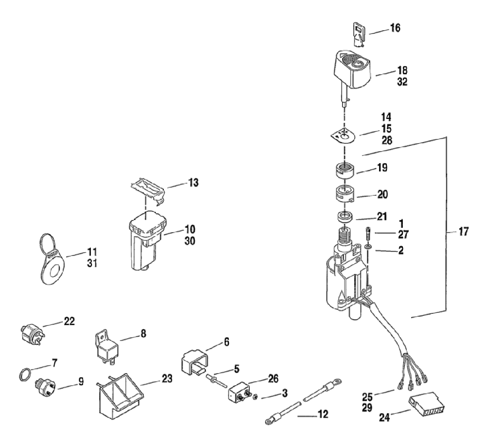

Originally Posted by Mr. Mike
My next move would be a new flasher...its cheap.
His bike has a TSM or a TSSM, not a flasher and neither of them are cheap.
68920-01D* MODULE, TURN SIGNAL CANCELLER* $134.99
68922-00D* MODULE, SECURITY SYSTEM* $238.49

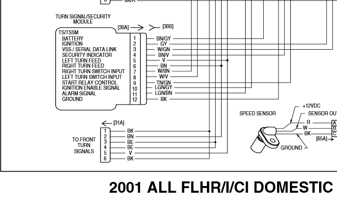

Part number 10. That said, that probably isn't it. I'd say you have an open in the wiring. Look there first if the bulbs have been switched out and are verified good.

The 2001 RK uses a Turn Signal Module or Turn Signal Security Module instead of the older flasher.
Edit: Max beat me to it.
