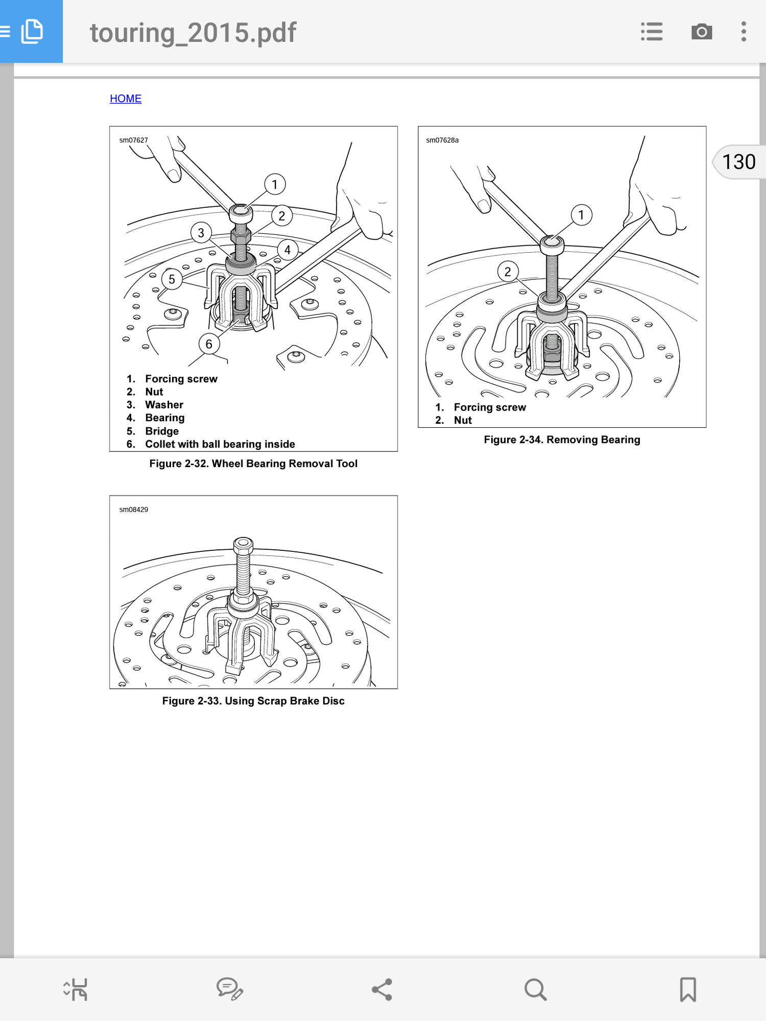

The bearing that dawg is referring to is item 4 in the picture below being used in the bearing puller. Not the acual wheel bearings. Makes the job go smoother and less binding on components. Also as he noted, lube the threads on the puller and installing tools.
Gotcha. I thought that he was talking about something else after I hit reply.

Is that just a wheel bearing? Would one of the old ones I took out work?
The Pit Posse tool seemed to work just fine.
