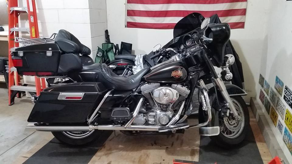

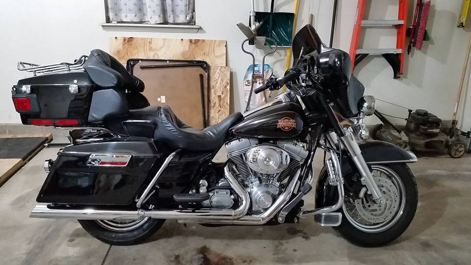

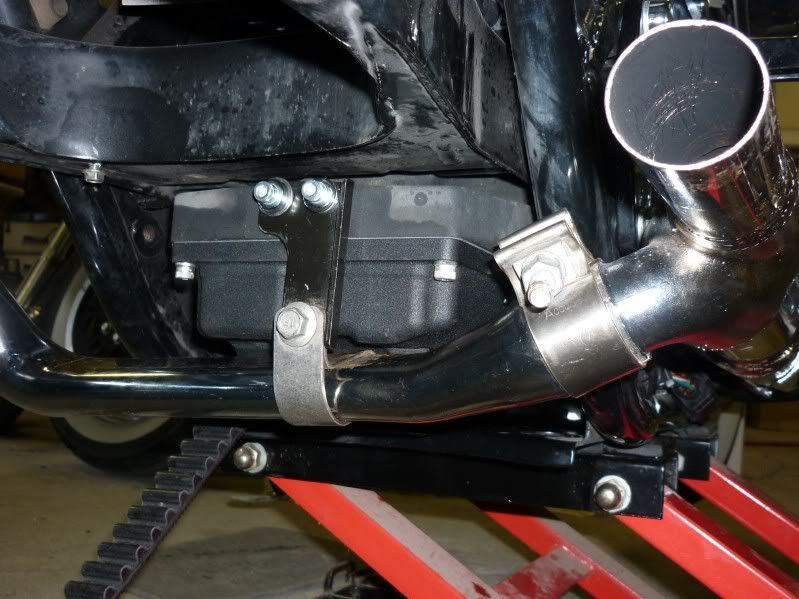

I do like to work on things and save money, so I put a 2010+ stock header from craigslist on my 2002 FLHT last winter. You will need to also upgrade to a newer oil pan, which you can also find cheap on ebay. I cut the cat out of the newer pipe and really like how it turned out. All in, I probably spent half what it would have cost to get the S&S pipe.

Originally Posted by Tarkus60
I can understand that ...got any pics?
The MOST scary part of the project is you have to drill and tap a couple holes for the bracket the supports the pipe that goes under the frame...
I did mine over the winter and have had no leaks though...
