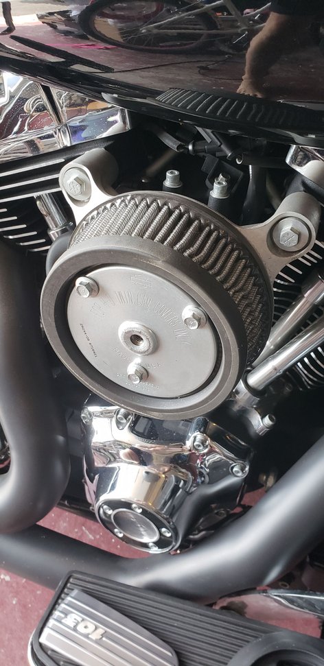

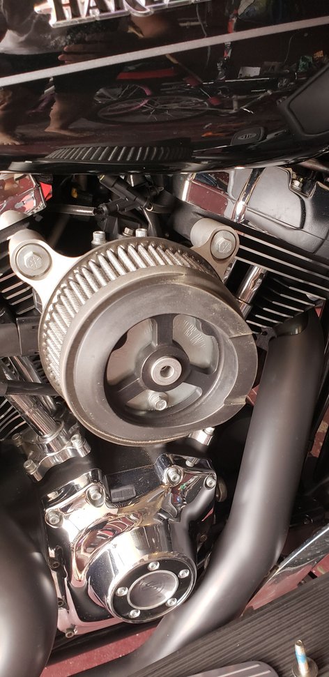

Bought this flhtk from the dealership, with v&h pipes, is this a stage 1 air cleaner?
Whars the difference between this and stock?
sorry for the noob questions...

Yes, look up the stock configuration here.
awesome, thatll save me $300!!
