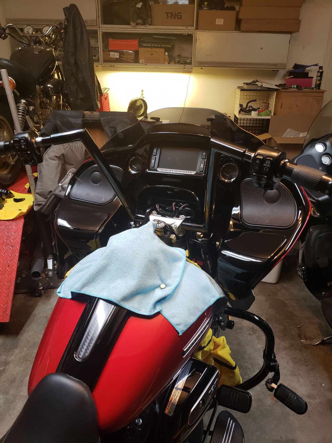

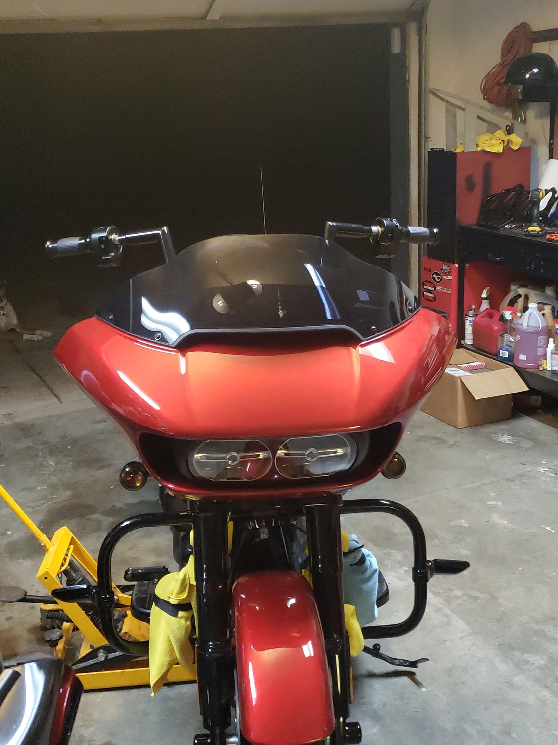

Put 14" Yaffe bars on mine, made a world of difference!

Looks good! I think I'm going to go with the 12" Krome Werks Ergo bars, back or the Up?

I put 14" KST bars on with Avon grips. Stock bars are too low and put my wrists at a weird angle. No extensions needed.

Jerryleejr,
Nice looking Ultra! How did the install go? Did it require new clutch or brake cables, or any wiring extensions?
-Mike
Old Jul 31, 2018 | 08:06 PM
Pfdr11b's Avatar
Pfdr11b
Stage III
Joined: Jul 2018
Posts: 3
From: Tn
No, all stock wiring and cables. There's plenty of length on the stock wires. You do have to cut(very carefully) the zip ties that hold the brake and clutch cables to the tree. I just slightly loosened the banjo fittings to rotate them down for a little more slack and a better fit, don't let any air get in the lines. Here's a great video to help.
https://youtu.be/ja0nJaMNraE
They've also put up a video putting 16" bars on with only extending the wires. They sell a kit for $35, $43 with shipping and that's all you need.

Originally Posted by Hethen57
Jerryleejr,
-Mike
I bought a +3 clutch cable only because I didn’t want the stock cable rerouted. Everything else stayed stock.
JJ
