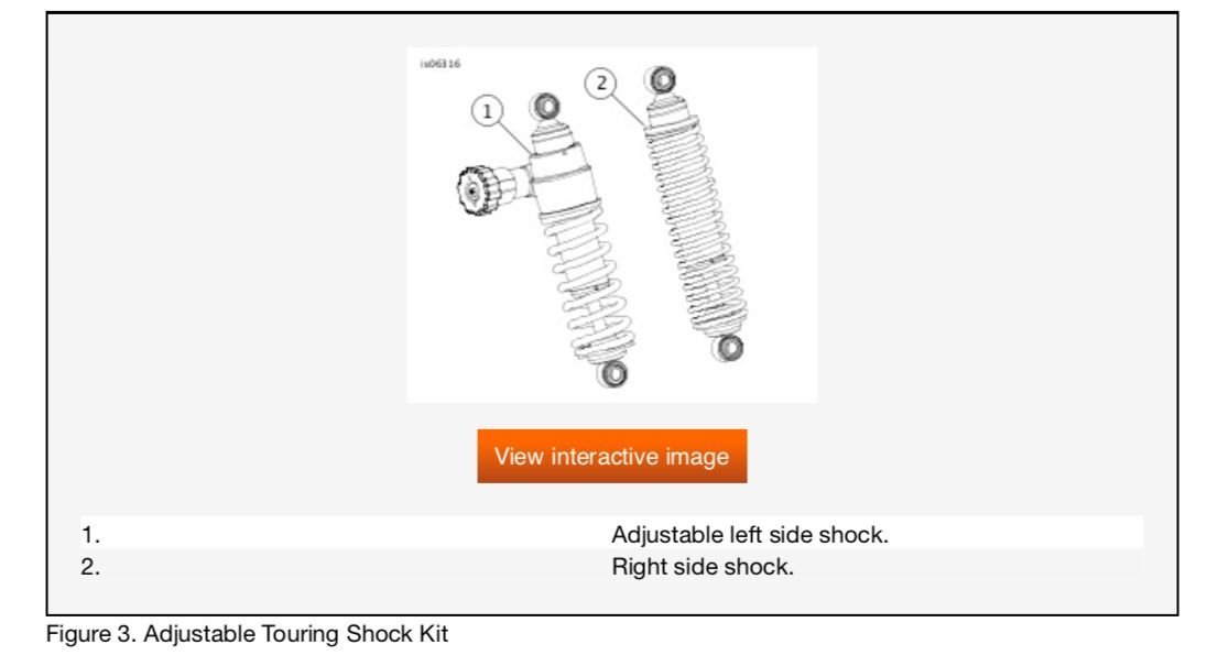

here is what I found, from the instructions from H-D’s Website, , and is how I mounted them.

On my 2017 Ultra Limited the throttle side shock was mounted opposite of this diagram. Which seems to be upside down to me, but in all reality, it doesn’t matter.

If you plan on adding a 4 point docking station it does matter how the right shock is installed, and it should be as shown in the above pictures. I have a 2015 Streetglide and mine came opposite of the picture and I had to flip it end for end because the other end is too wide for the backrest mount to fit.
I'm 195 lbs and I have mine set at 3 turns which I think was 6 clicks.
