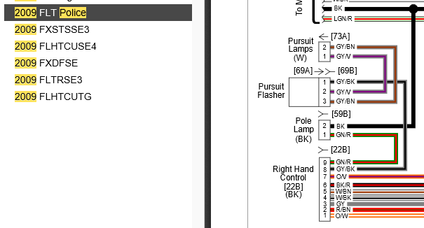

Are you talking about the Pursuit Lights (otherwise known as passing lamps or spot lights) that are one each side of the headlight? Usually, on Police models, they are controlled by the Off/Aux/Pursuit switch on the right hand controls. Power comes from the "Brake Light" fuse to the Pursuit switch to the Pursuit Flasher to the Pursuit Lamps. It sounds like yours has been changed from the factory setup.

Yes, the pursuit lights that normally would be red on the actual police bikes is what I'm taking about. There's still the siren switch on the left handlebar and the pursuit (passing or fog) lights has a toggle switch on the left side, just below the left handlebar. Not sure who installed it, but the bike was actually used by a police department, so it may have been a switch installed by that dept.
