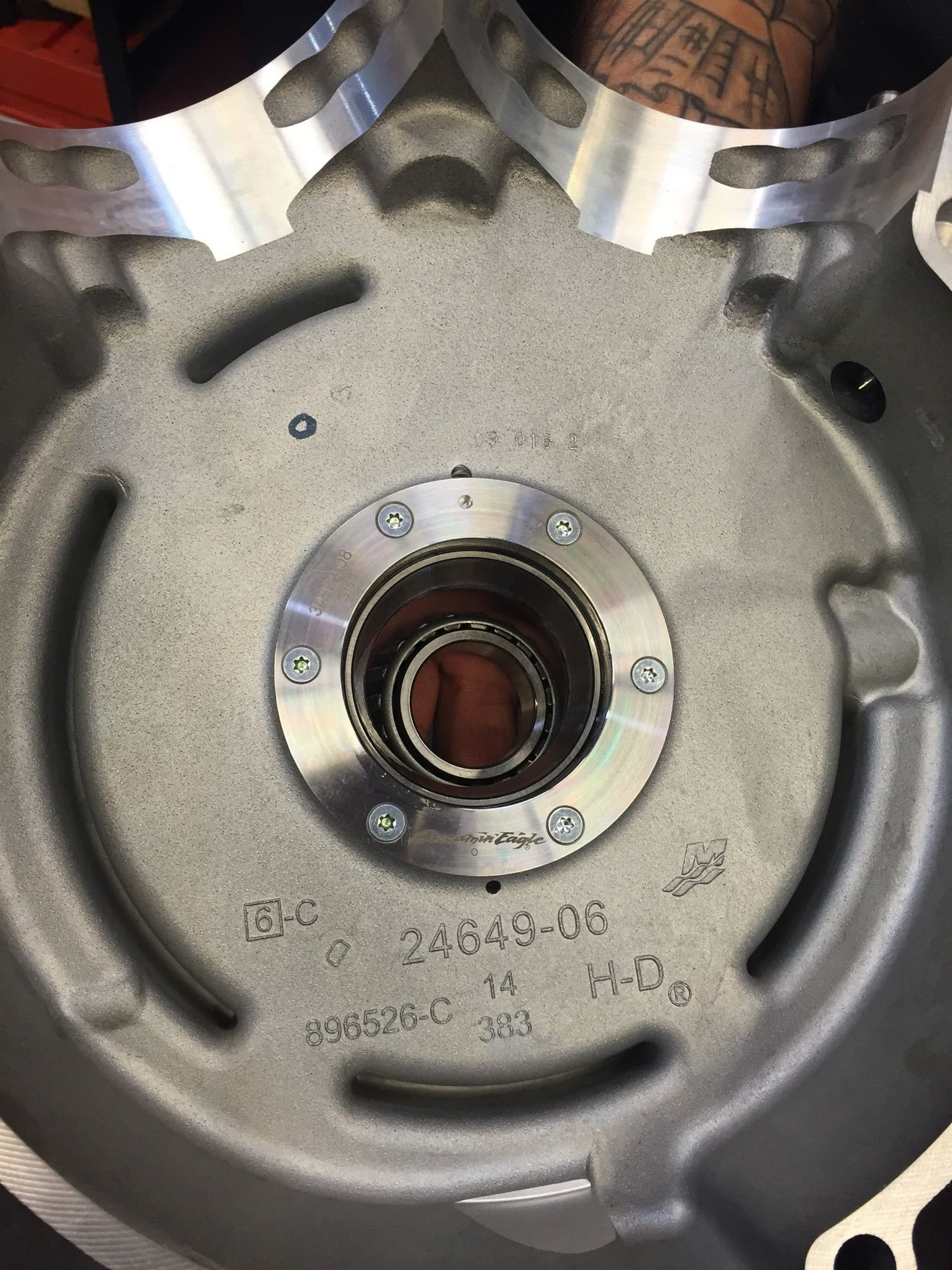

When I upgraded my 110" motor to the 117" Pro Race Big Bore Kit, I sent my Crank to Dark Horse to get some love.
In addition, upgraded every new part inside the motor and added a SE Timkem Bearing. It made a big difference performance wise.
