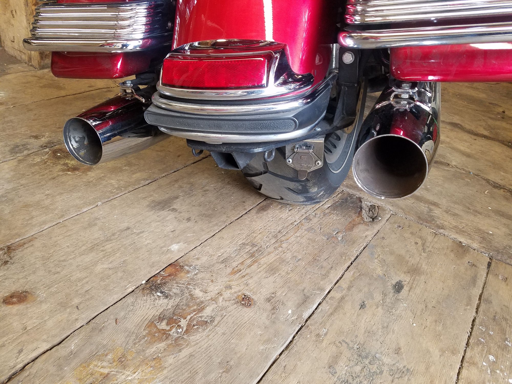

Mt 2013 Ultra Classic has a trailer hitch on it. Well, half a hitch. It's missing the bar with the ball that slides into the receiver on the bike. The PO passed and his wife has no idea where it is. I would be willing to bet he had it installed at a dealer since all the paperwork I have on the bike is from a dealer.
Here's a pick. Hopefully someone will know where I can get the missing part or better yet, links I can go to.

Go visit your local welder/fab shop. Make a new hitch. Piece of square tubing and a plate welded on top with a hole to mount the ball.

Probably a standard 1 1/4 hitch. Can get at most stores.

Try HitchDoc. They specialize in motorcycle hitches. Would surprise me if that isn't on of their hitches on your bike.

Measure the opening and search online?
Is there a brand name on the hitch?

What Bulrid8 said. Looks like a standard 1 1/4" receiver. Any 1 1/4 " hitch should work.
Do you have a trailer? You'll need to measure the tongue height on the trailer when it's level and the receiver height on the bike. Then do a little math to determine which hitch you need ( higher or lower ) so the trailer is level when your towing it.
Amazon has a huge selection or any local trailer/truck rigging shop.

Measure the opening, I'll bet it is 1 1/4". Go to www.etrailer.com and get a replacement. The ball can be 2" or 1 7/8" depending on your trailer.

Yep, Like others said, looks like a standard receiver. It was reccomended to me to use a locking pin so there is no chance that it will vibrate out. Plus it adds security so no one will just walk away with it.
