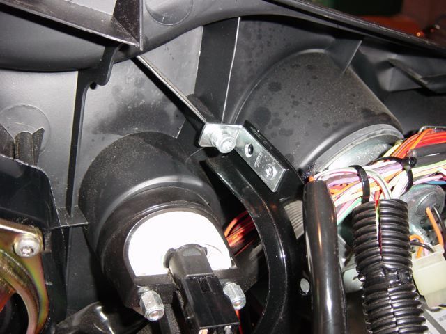

Here are a couple of repair pictures that have been posted in the past.
