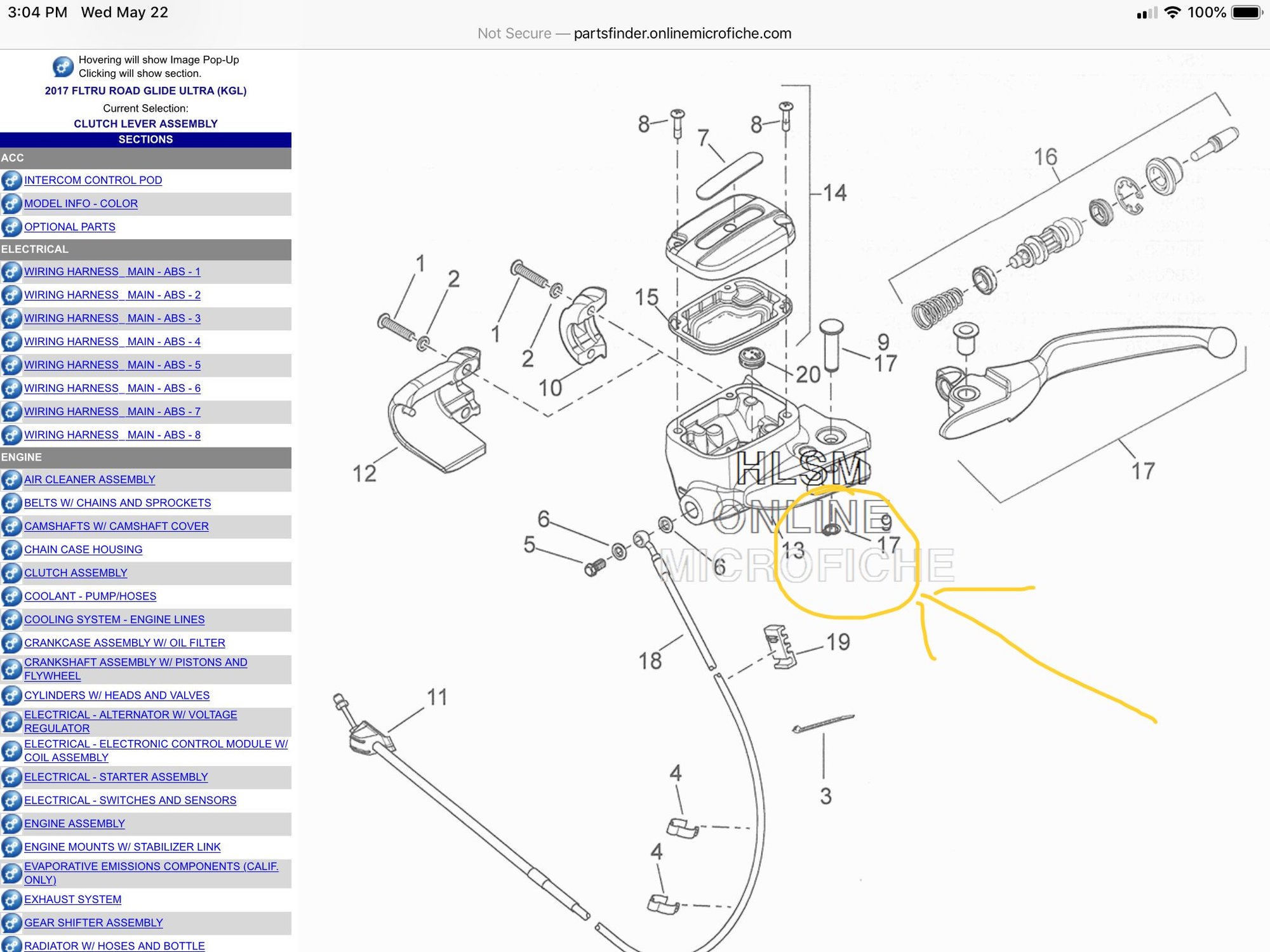

Does anyone know the correct size so I can go to the hardware store and get one?

Can you take the pin with you, or take the snap ring off the brake lever?

I found one at Ace's hardware for a time being not a perfect fit since local shop didn't have one in stock. For somehow you just can't buy the snap ring ( local shop said) had to buy both even it's a very old part number..But some how my little dog found it after few weeks.

I got one at Lowes

Mine went flying when I was disassembling and lubing the clutch on my old Street Bob. I took the pin to lowes and found one that fit. I picked up 4-5 of them for a couple bucks.

Use a 7/16" E-Clip It fits just fine and way easier to get on and off
Get it at Lowes or Home Depot or really any hardware store.
