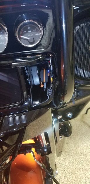

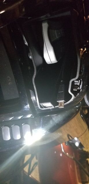

I left it behind the fairing, drilled a 1/2" hole in the back of the phone cubby, ran the mini USB cable through a rubber grommet and have the Freewire plug permanently mounted. I also have a USB to 3mm power cord plugged into the USB port, so both power and DIN are plugged into the Freewire permanent. When I power the bike on the Freewire automatically powers on and I never have to charge it. I just leave it in the phone cubby full time. In the pics you can see it next to my garage door opener. Once you get all the cables tied up and moved to the back of the cubby (it's really deep) you can move the Freewire around so that you can access the button or in my case the button and the garage door opener. Under the fairing I just tied up the cables and stuck them in the cavity next to the radio. Nothing is really clean under the fairing but I did the best I could with the myriad of wiring under there.

No problem. I am glad to share as this is not a typical or widely known solution to the WHIM debacle. As long as you have a Bluetooth 4.1 headset this works like a plugged in headset. I get stereo on my non HD headset as well.
I plan on testing the Cardo system with the JBL speakers soon, there is question on whether or not it will connect to the Freewire, I hope it does so I can get it. Now that I can use a headset to listen to the XM Radio I really love having the option and would like better speakers.
