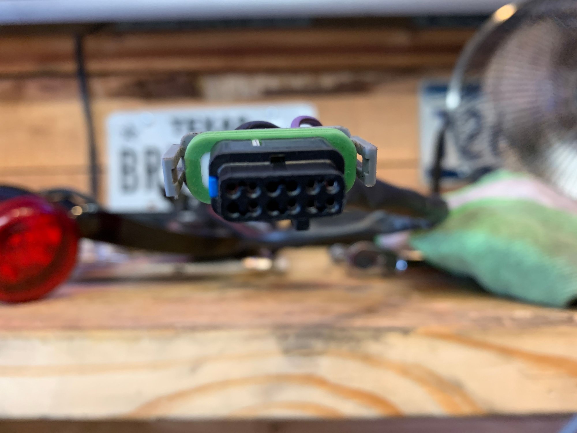

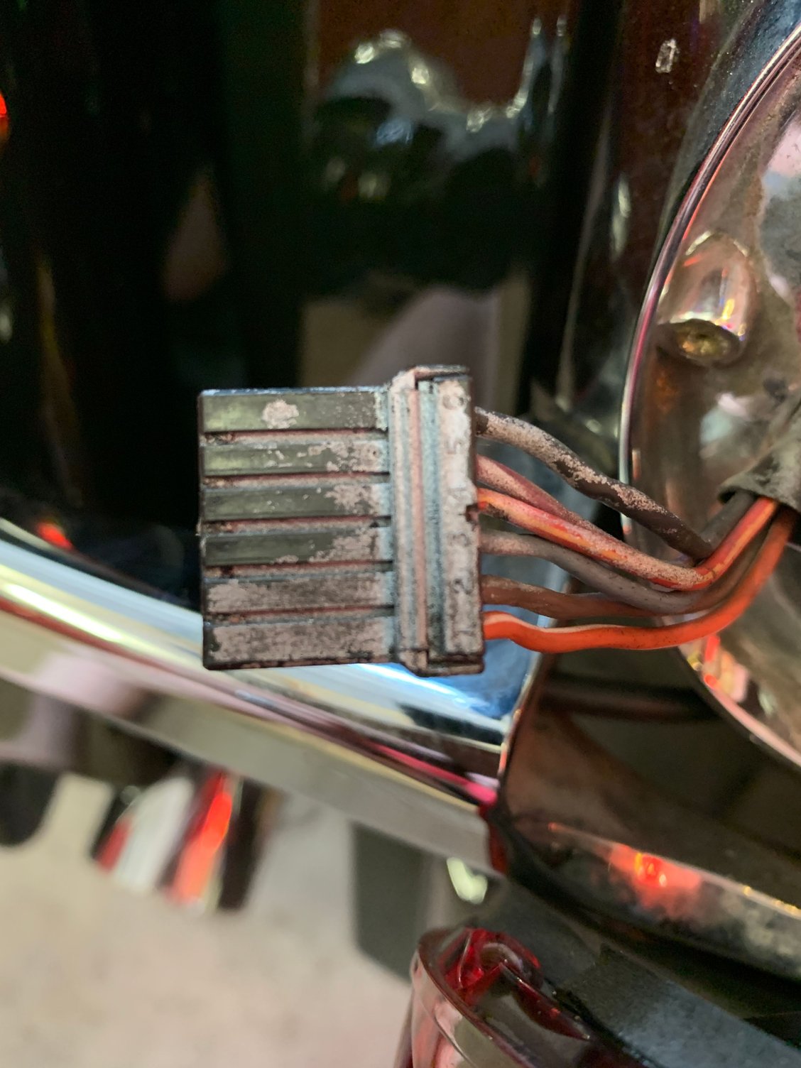

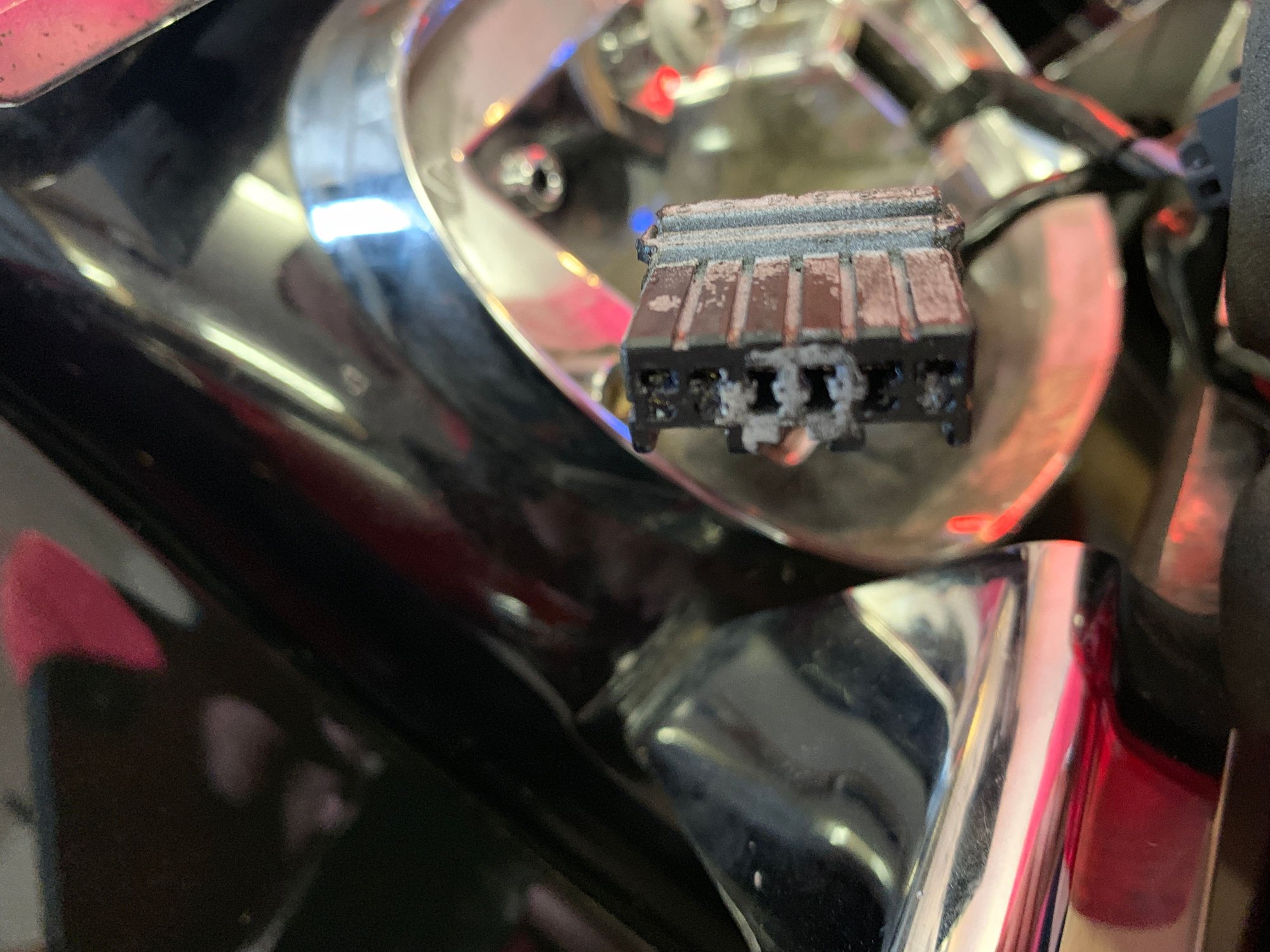

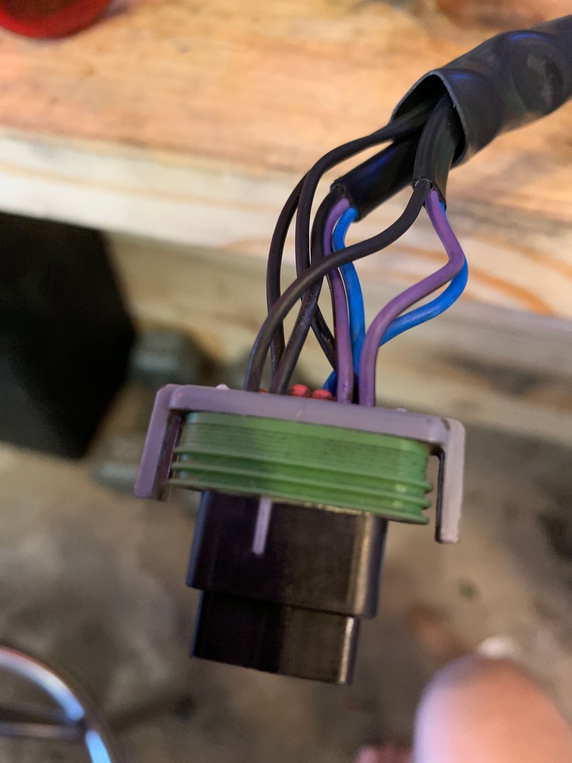

I just picked up a new to me 2004 Ultra Classic and am doing a rebuild and I'm looking for a little guidance on the rear light harness. The oversized rear tail light and lollipop style lights aren't my thing so I picked up a bullet style tailight assy and plan on relocation the license plate. I'm looking for a light harness that will plug into the stock wiring harness (6-pin) and will plug into the 2014 or better molex (8-pin) connector. Any suggestions?
Existing harness
existing
Bullet style light bar

They make a bullet light bar for a 2004. It comes off of a road king of the same year. That's a plug and play light bar. I got mine on eBay. There may be a way to change the connectors on your current light bar as well.

The 2004 Road King Custom came from the factory with Streetglide Bullet rear turns, check out the microfiche for details...
