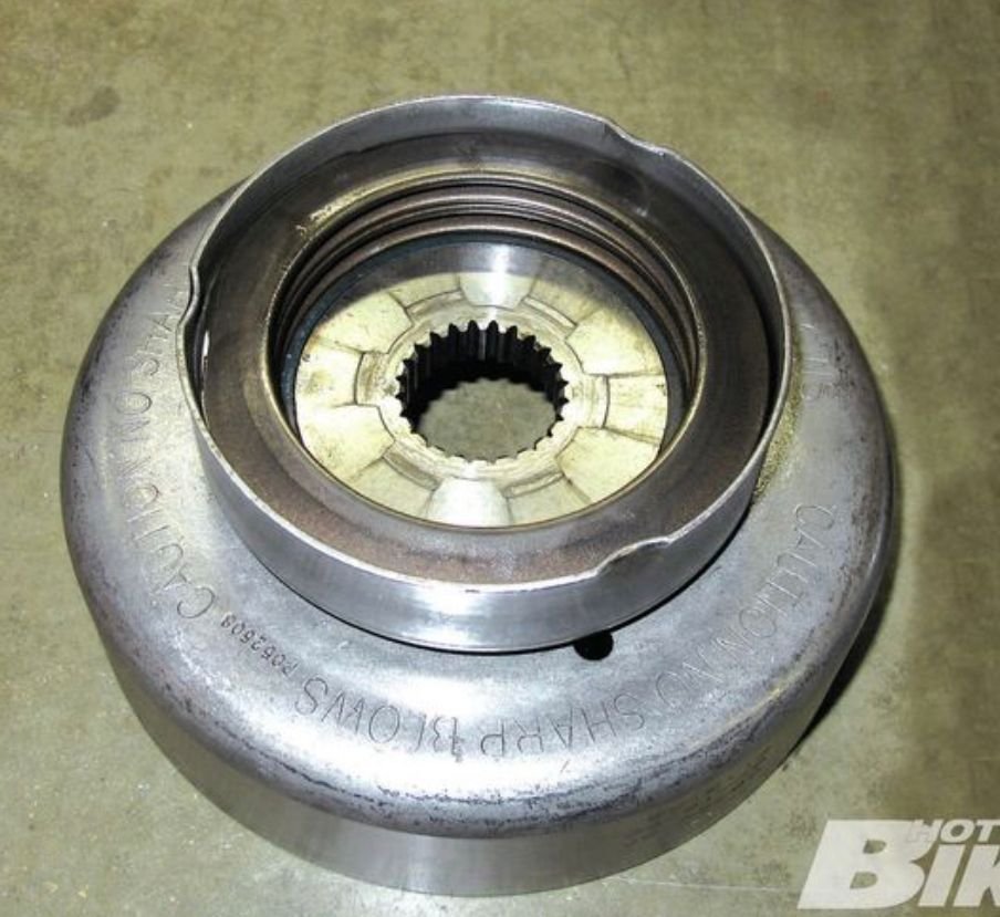

To help clear up your confusion, the bolt and washer are torqued to 140 lbs always. But the gear and cam are on a splined sleeve and can move. Behind everything there is a multi piece spring pack. The larger pieces usually don’t wear quickly. But the springs have been known to break and the spring packs can come apart. I’ve had both happen to me but I have a lot of miles. If the springs aren’t broken and the large parts aren’t heavily worn there’s not much to worry about. If you aren’t getting any loud banging noises when you take off and you don’t have more than a stage one done to the engine I would inspect it and put it back.

The spring pack doesn’t look like much so probably didn’t stand out to you on the Ronnie’s site

I know some members in your previous posts have mentioned it, but I am not sure that all members understand that your ‘09 compensator is not built like the original SE or the later compensators.
Look at the photo cncmike posted.
On the ‘09 (and some earlier years, then thru 2010 except those equipped with the SE comp. like the trike) have the spring-pack built into the rotor. There are no separate springs like the later units, you can not separate the spring from the rotor.
I do not know if it is true, but I recall reading that HD no longer offers replacements for that rotor, you must replace the entire compensator and rotor if either goes.
So, if you need to replace your ‘09 comp. and it is the original (has never had an SE comp replacement installed) you must replace the rotor and the compensator, but you must get a compensator that has the included shims and springs that some of the SE compensators do not come with (the HD kit you would need is #40100061 which has everything including the rotor.) If you go to a Baker compensator you still must replace the rotor but it uses its own spring-pack set-up.
Hope this clears things up a little.

You can still buy them. I bought one at the dealer in October. Surdyke and New Castle have them online for $175.00. The part number is 40356-07 (this information is for the spring pack only)
