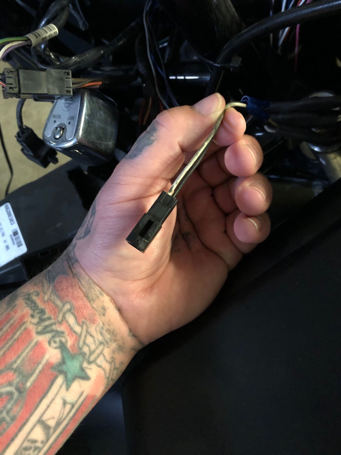

Changed out my bars on my 2012 road glide. Re wired everything and put it back together, all lights gauges, radio and blinkers all work how ever the run/ kill switch dose not, I have 1 plug I for the life of me can not find where is gose. Pulling my hair out.. please help, it’s coming from my right side handle bar I know it’s not for my heated grips. Any help would be greatly appreciated

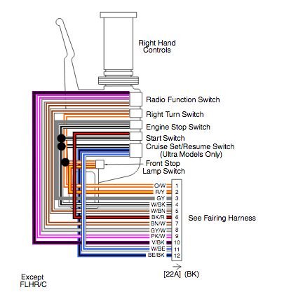

That's to your run/kill switch. Here's the wiring diagram:

I know it goes to my run/ kill switch the problem is I can’t find the connector on the bike, anyone have a clue where is would be located?

I think it plugs into a 12-way socket housing that should have other colored wires plugged into it shown in the attachment.
I'm sorry I can't be much more help. Good luck.
