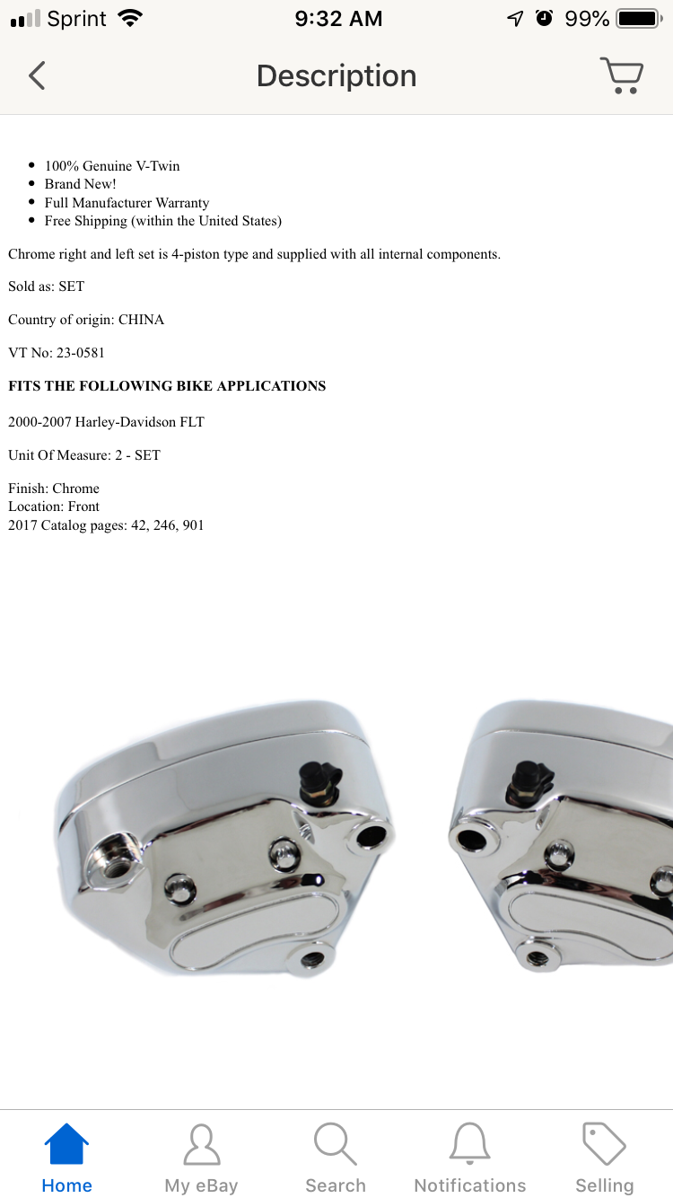

So my bike has been down for a month now doing the 21 inch front wheel chrome forks 16 inch bars chrome hand controls all new cables exhaust seat speedo etc. I sent out my calipers to have them chromed when I get them back they are horrible I cannot get them to stop leaking. The chrome shop was horrible banjo bolts wont seal. Along with many other issues.So I’m trying to find something temporary . I decided on drag specialties calipers for now. I order a lot of things from Dennis kirk they seem to be out of the right caliper made by drag specialties.Along with everybody else. My bike is obviously a dual disc set up. I have a 2007 road king classic I found these calipers I’m wondering if these will work the only description is they will fit a 2000 to 2007 FLT.Somebody please let me know if you have any info I would love to have my bike back on the road. The only other calipers I wanted said not for use with 21 inch spoke wheel...

Same same, should hook right up.

Sweet I cross referenced and searched for hours last night.But still wasn’t 100% sure.Apparently v-twin drag specialties and there’s another brand hard drive are all the same parts.You can’t find a front right caliper anywhere they must be out of stock and are not making any...thanks
