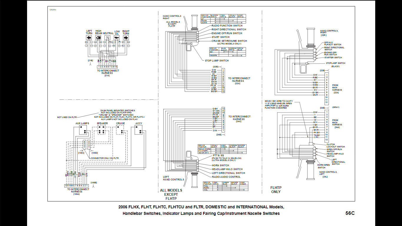

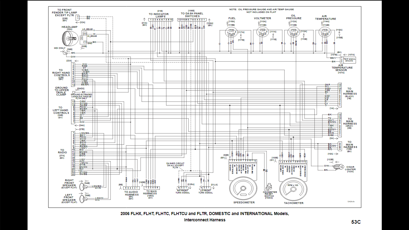

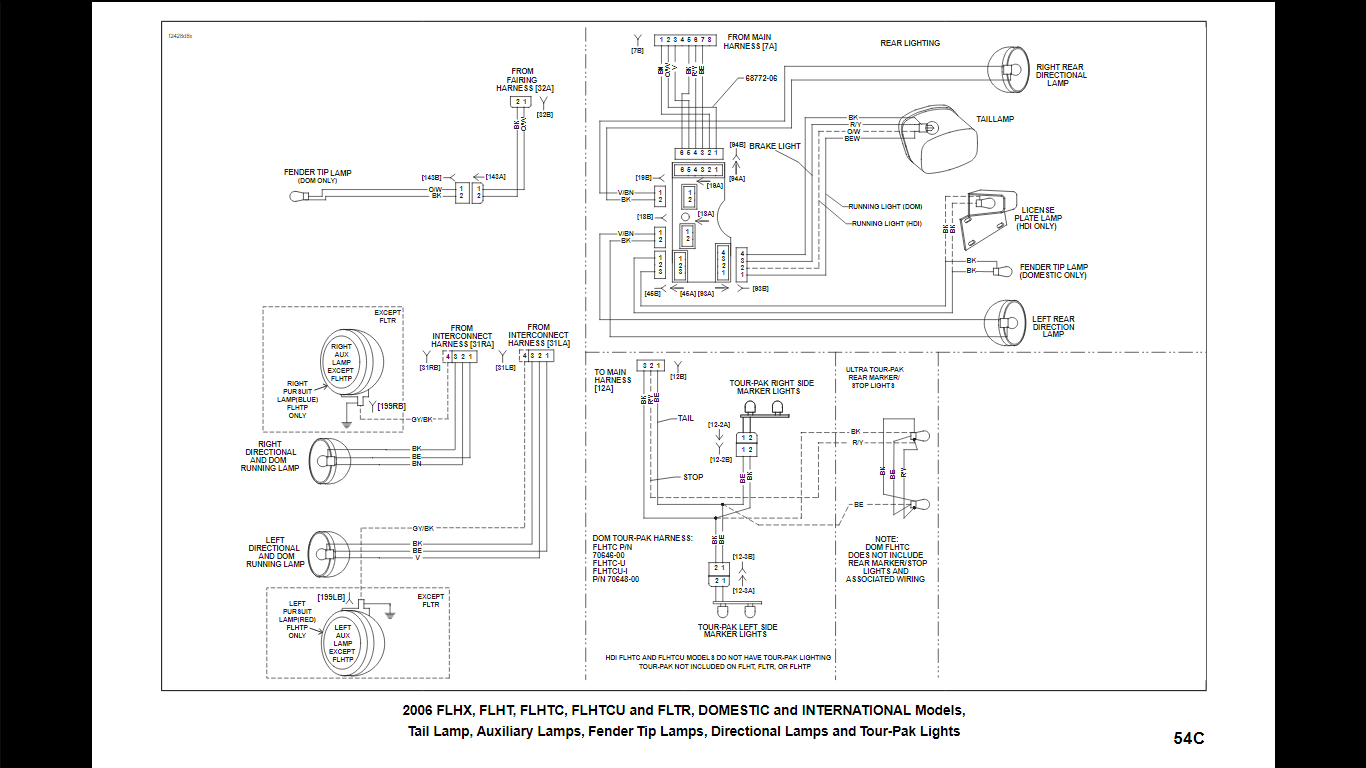

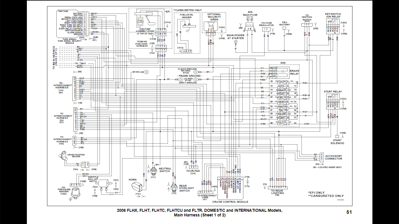

You can find the schematics at this site:
https://serviceinfo.harley-davidson.com/sip/
Sure makes me think the TSM is not working right. http://partsfinder.onlinemicrofiche....UIT%20BREAKERS
I would measure the voltage going to the TSM for the Rt blinker and make sure it is 12V +, same with output from TSM to Rt lights. Inspect all connectors to make sure pins are good , positioned well and clean.
