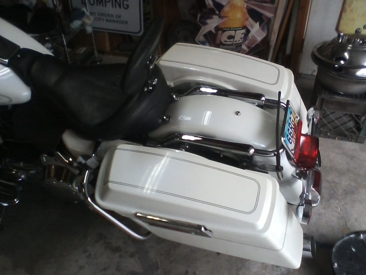

Is this piece structural??

Some say it is, some say it isn’t. I wanted to take mine off, but was Leary of something f’ing up. Left it on. Looks like yours. If you drill new holes in the bevels on the plate holder it will lay back and look better.

It looks pretty stout for something that was only for holding the license plate.

I would have to say it’s structural. It’s called a support tube and it bolts the two sides of the rear of the frame together. I would think removing it could cause stability issues.

It would not be on the bike if it did not perform a purpose. So it's definitely there for a reason and it's not to hold a license plate.
It is very noticeably missing on newer touring bikes post 09 as the frame changed.

thanks for all the great answers. its a tough call. companies make covers and lights and there are millions of people that have removed it with out issue. I have a buddy who bought a bike with it removed and has been chasing a high speed wobble. I may let him try mine to see if it fixes it. I actually ride my bike so iam leary of removing it

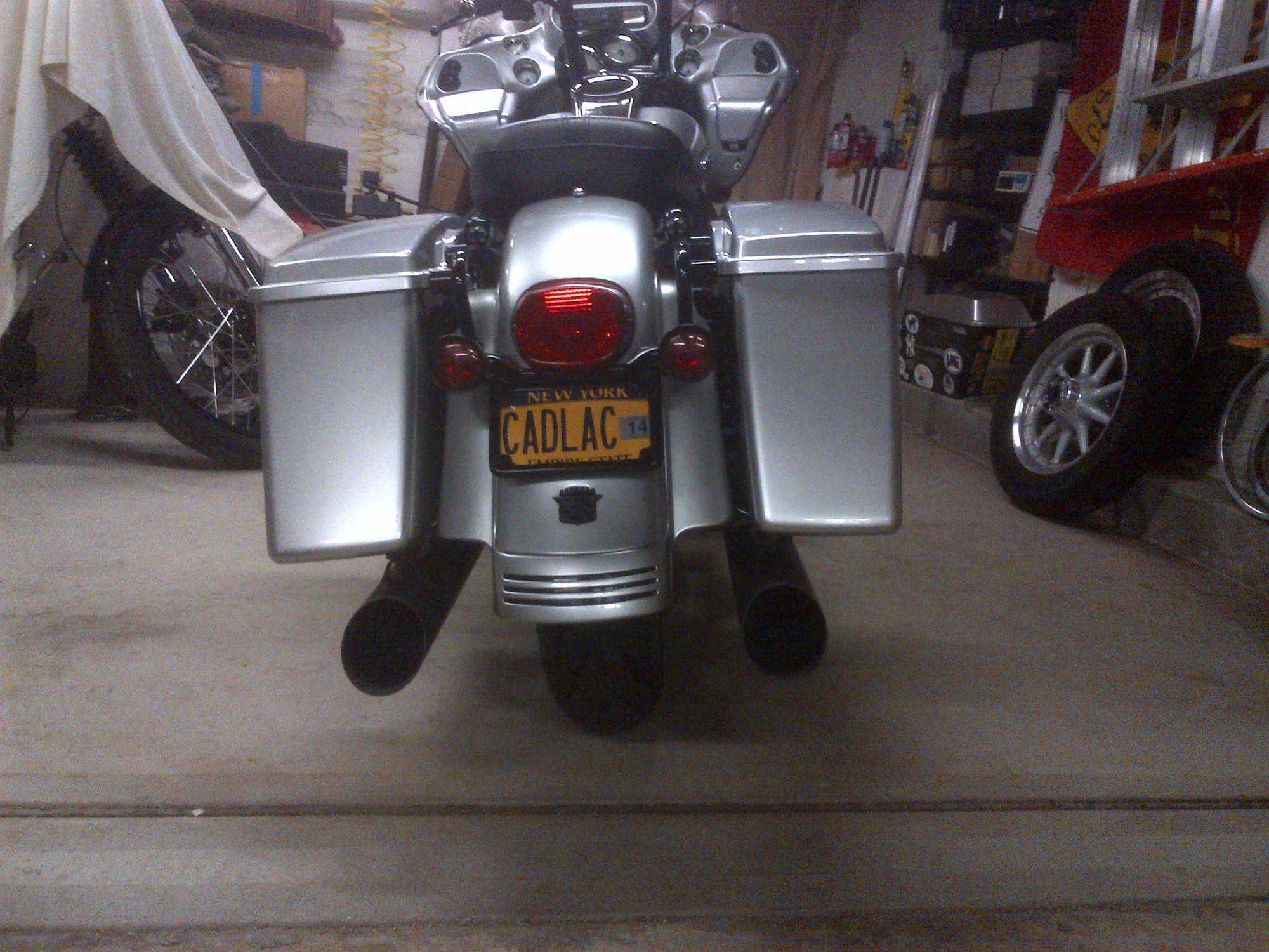

I eliminated mine about 7 years ago. I have put about 30k miles on the bike since then, always Two Up and usually packed heavy for the long ride utilizing a detachable Tour Pak. I have never noticed a difference. I removed mine, cut it and then installed "plugs" from Paul Yaffee. He may also sell the lights, not sure. So the original plate for each side goes back on the bike so you do not need to add any shims. I think I have seen the lights you are talking about, probably acts the same way. I spoke to Yaffee before I did it, he said he has done it to dozens of bikes with no negatives. I agree it seems awfully stout to hold the license plate, but many of us are out here with it gone and still alive. Good luck with your decision.
