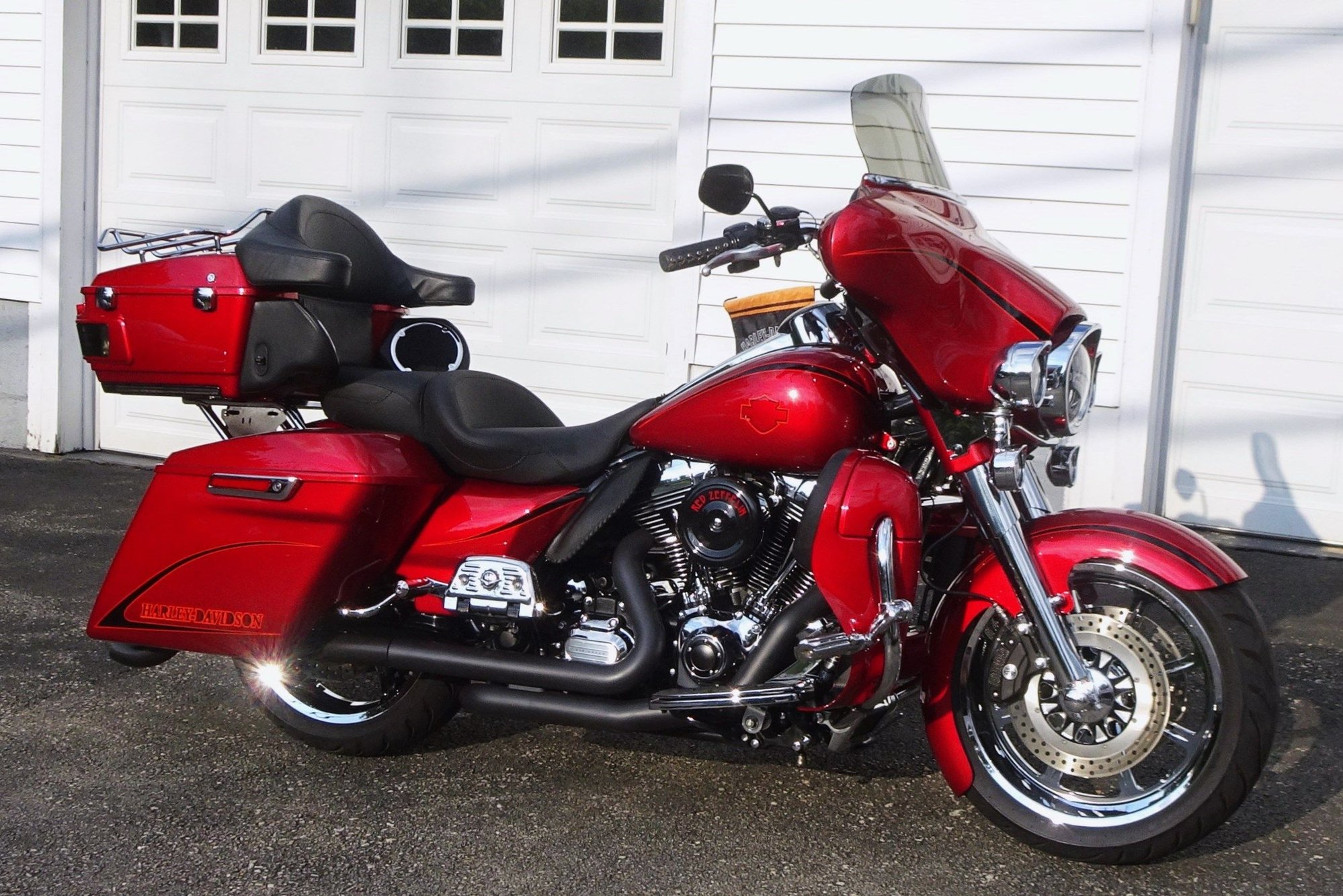

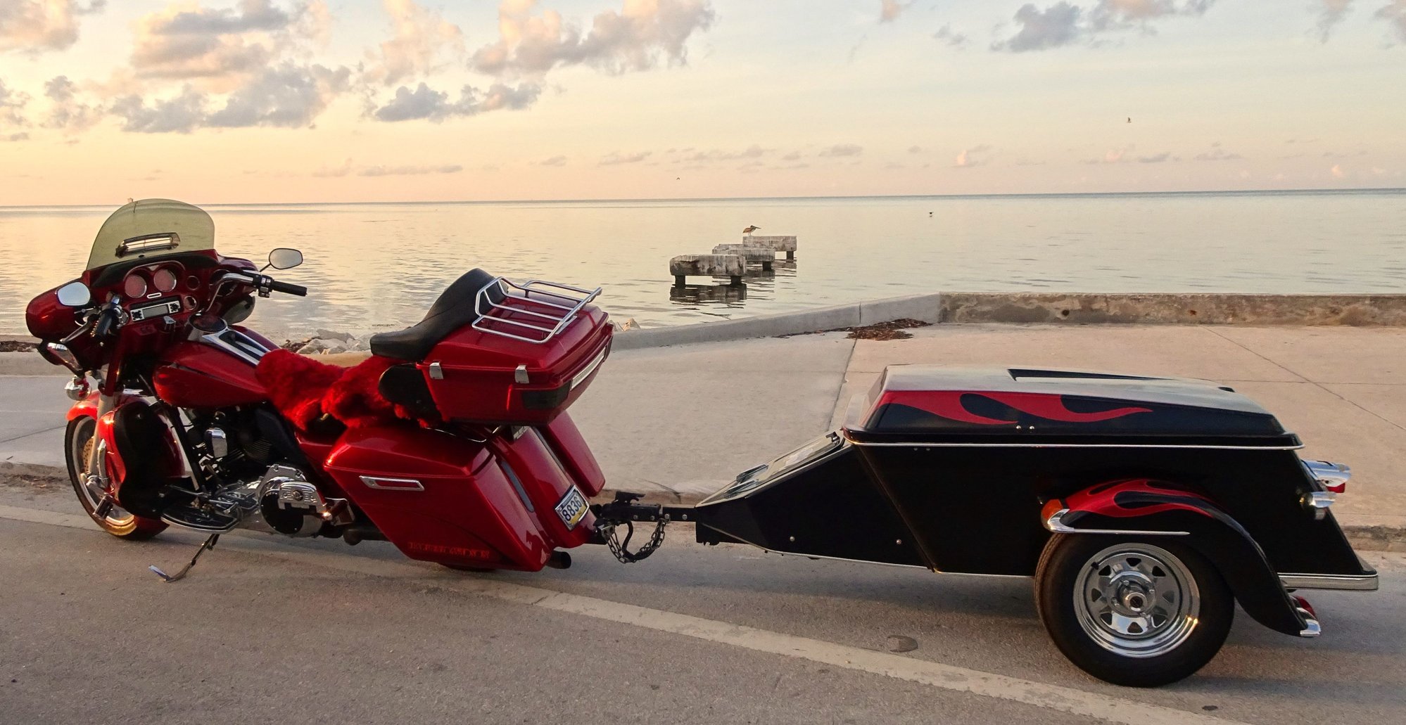

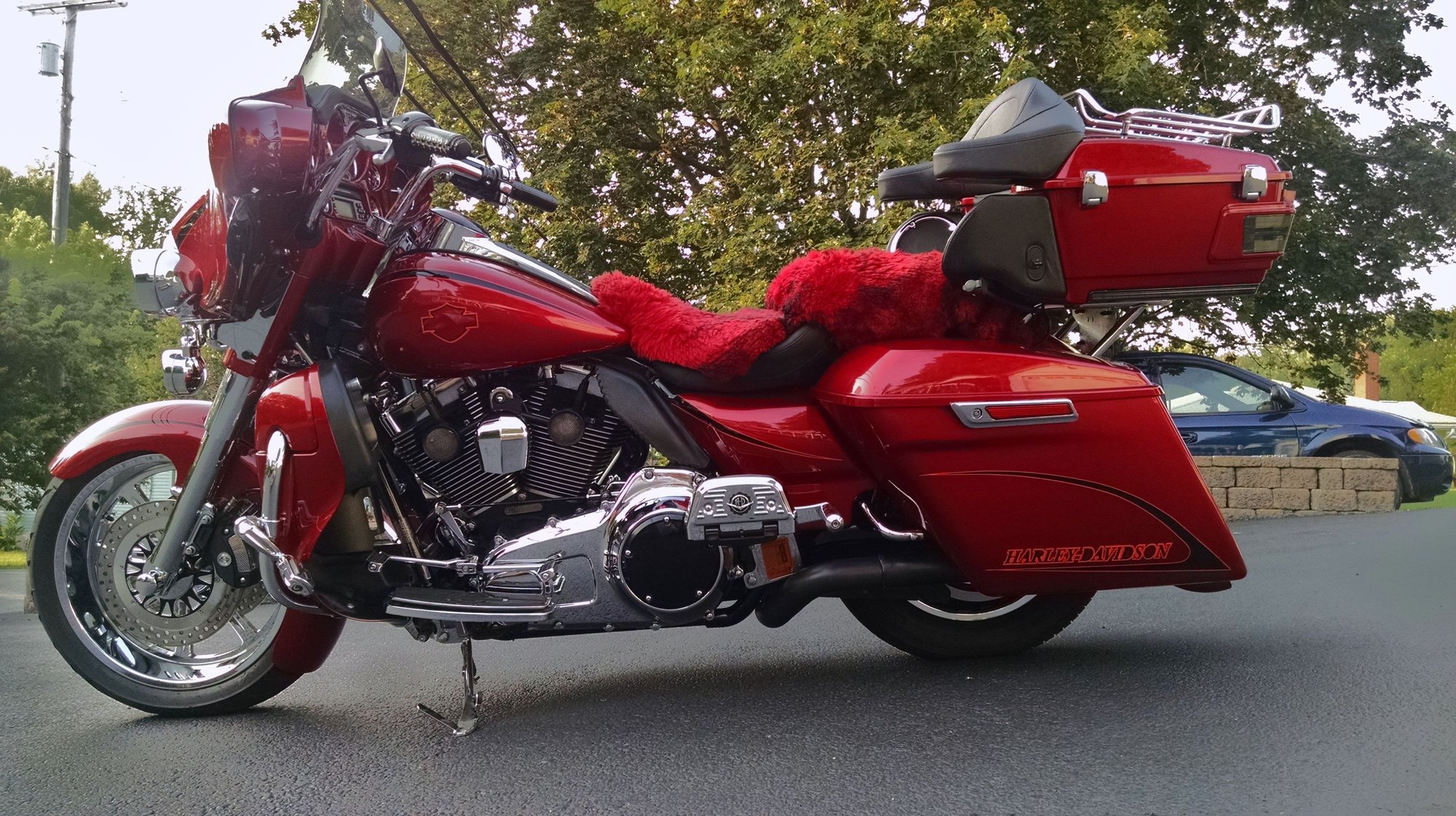

Many of you have seen posts and pics of this bike on some threads and I have been asked to post more about it on a separate thread so here it is. My goal was to make it as dependable and comfortable as I could along with performing to my satisfaction for longer distance while pulling a trailer in all conditions. In the last three riding seasons since I feel I've reached those goals and beyond in some cases.
Started out with a stock 2012 Limited that had all the usual downfalls, overheating, constant pre-ignition, suspension short falls, compensator issues on & on. In short, I was looking for a better performing, dependable bike in all temps and conditions, since my career was auto/truck ,cause and effect based to increase fleet dependability I figured I had the basic experience to pull this off. I may add that I didn't just throw money at it , I like to spend my money on gas, food and hotels so some of the frugal guys may appreciate some of my efforts and results.

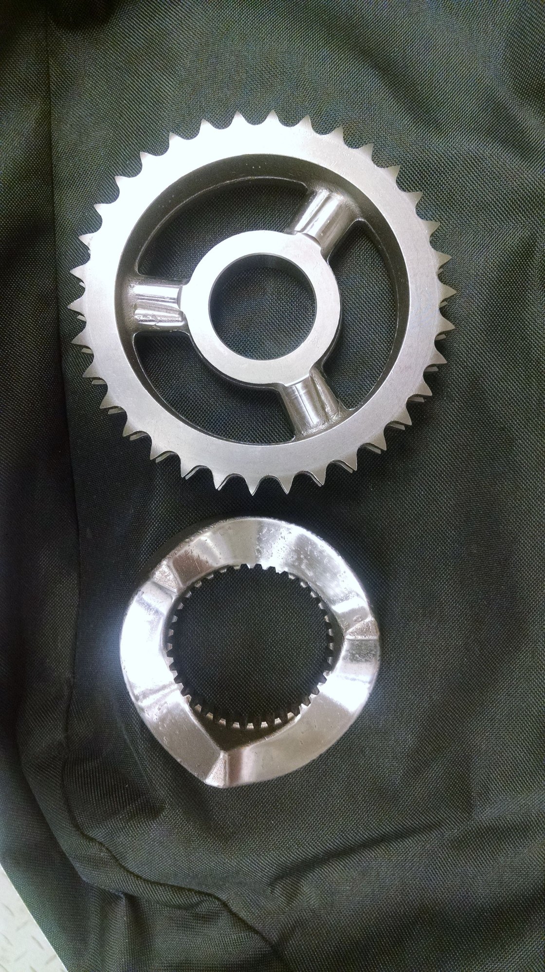

I'll try to be brief and to the point on each topic so we will start with the compensator. I'm sure nobody is a stranger to the lack of longevity of said part, going through 2 in 40,000 miles neither was I. After the introduction of internal lubed version , 42200064A, I decided to make things work smoother and longer with less wear, by polishing the mated surfaces (spokes and ramps) on the comp. This cut friction which means less heat, wear and no more metal particles in the primary oil that can only be more healthy for the stator, bearings and clutch. Mission accomplished, 60,000 miles on comp with no wear in sight, only anti-seize looking material on plug magnet on 5,000 oil changes, using Mobil1 20/50.

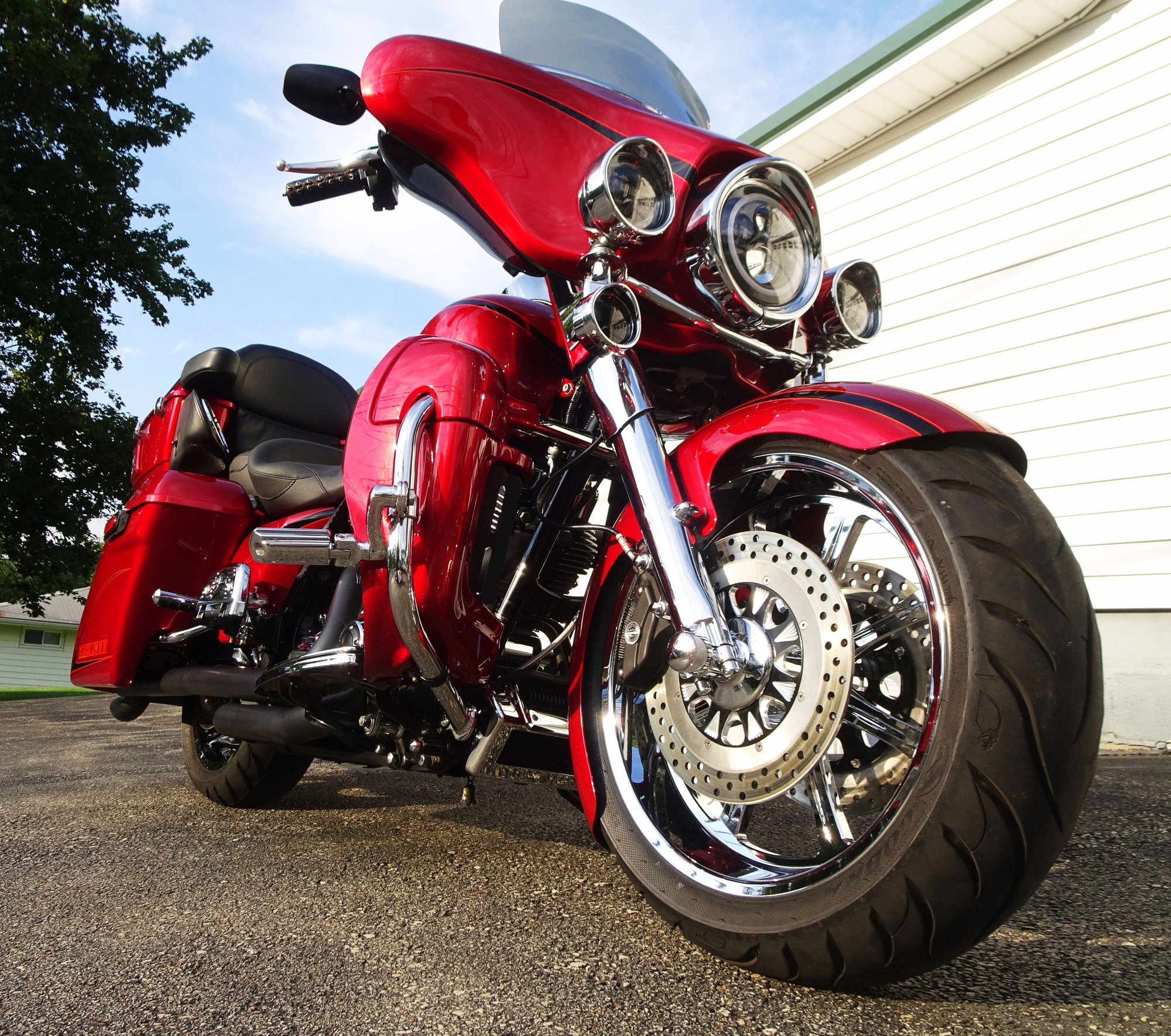

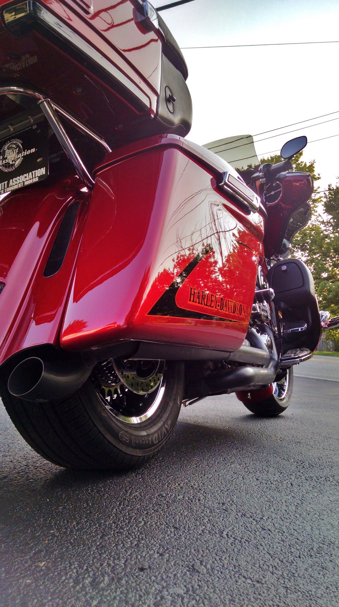

Went with cat tire on rear, Yoko Avid Ascend 195/60/16 have given best results for me, 40psi loaded and traveling, 36-38 local. Tried a 140 tire up front but decided to do the 180 conversion that I did myself, not a kit, for max results in ride, traction and appearance . Started with an Avon Cobra but was not satisfied with wear and handling coupled with the ct. Second season now on an E3 bias ply and very happy with 30,000mile+ wear, much better, exact steering coupled with the ct. with this combination pulling a trailer safety has highly improved . Rain traction, stopping, ride, dependability and wear is great and not a concern for me anymore. Coupled with Progressive 444's on rear and mono-shocks in front I have exceeded my goals in ride, adhesion to road surface and longevity on trips and per season.
Since you pull a trailer I wanted to point out there have been a few people that have had issues with using a car tire on a motorcycle while doing so. I even know one person that experienced this problem. This person crashed right after he installed a car tire (he was pulling a pop-up camper).
I think part of the issue is that a car tire has a softer sidewall than a motorcycle tire. That's why a number of the people using car tires on a motorcycle will use a run-flat car tire, since those tires have a stiffer sidewall.
You might want to read this thread.

I'd like to know more details on 180 front end home built.
