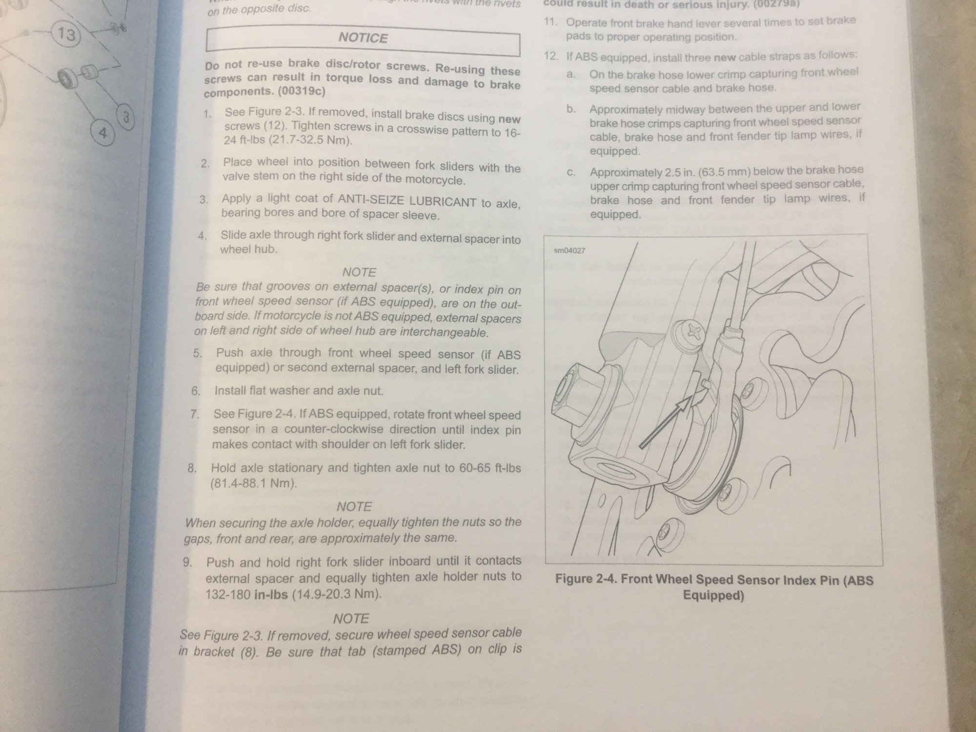

Might be worth checking that you have the fork tubes seated in the upper fork bracket.
I think BackRoader is backwards on which way to position the right fork when getting ready to tighten the axel holder nuts. You sure don’t want the fork away from the spacer with room for the axel to move. See step 9.
