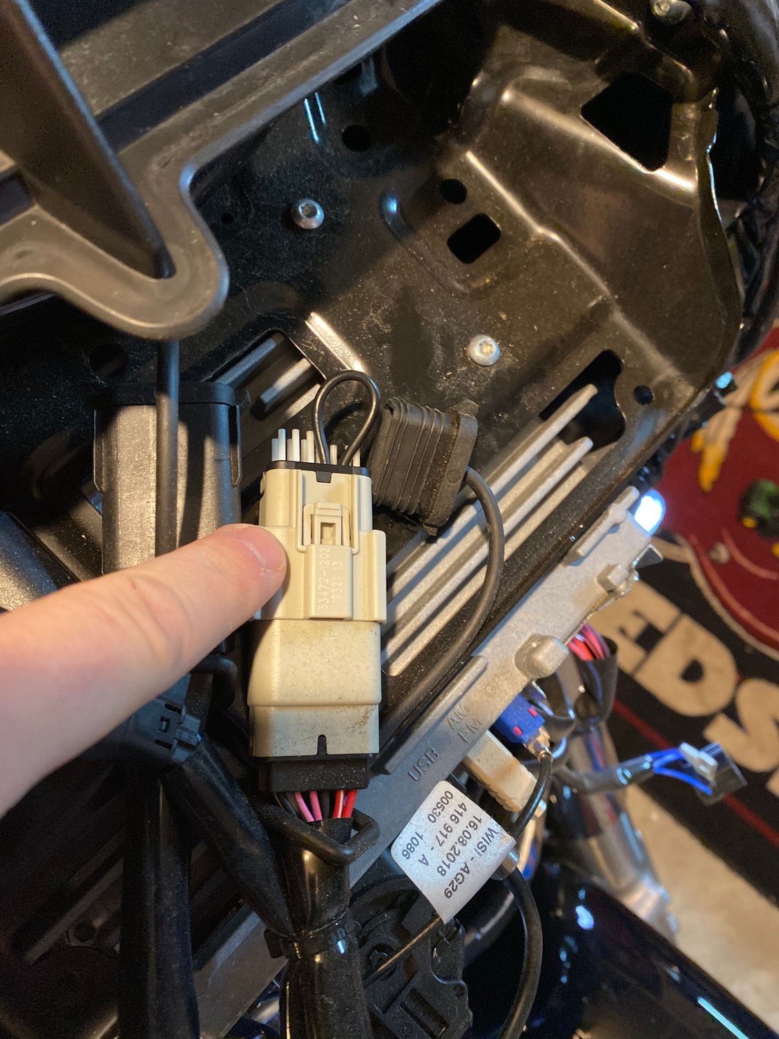

Exactly right! Except for the fact that you're completely wrong. The reason it doesn't work that way in your car is because the car already has a built-in microphone; essentially the car version of the bike's wired headset setup. As stated earlier, on the GoldWing the BT headset connects to the bike and it works through there, but HD being HD, they decided to make it so you had to buy more stuff to make it work that way, which is why Apple refuses to list them as officially CarPlay compatible. This jumper tricks the bike, and it just plain works.
I just installed it, and Siri talks to the phone via my BT, and CarPlay WORKS. Handlebar controls work for changing tracks, moving the cursor around the CP screen, too. No volume control via handlebars, but that was the same with my Cardo unit before, too. I just use voice to tell the Cardo to get louder or softer. The only oddball thing (and it was this way before today), is that once you start music on the phone when it's connected via USB, I have to hit the play button on my BT to send music to the headset instead of over speakers (and this might just be a Cardo thing), but again, I did that before anyway. Map apps work, music works, Siri works, all through the headset. Now, if you want to run this through your speakers and not a headset, then obviously you won't have voice ability, but you could just turn on your BT and put it in a pocket and CP still works over speakers, but just for output. I could see doing this if I'm wearing a half helmet or another helmet without a BT setup inside.
Beyond pleased that this is working - thanks, Brian Sofley! You're doing god's work.
