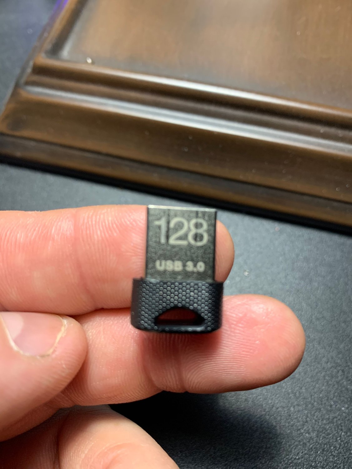

I use a 128 mini gigabyte flash drive in my FLHTK GTS without any problems, in fact, it's very fast and the music quality is excellent. Although I only have 1,577 files/music pieces on it which only fills it about 1/3 of it's capacity. I import the music from iTunes onto the flash drive using MP3 and M4A formats. All files are dropped directly on the flash drive without any subfolders. I know that method seems unorganized but the GTS can decipher everything just fine.

The fact that two different vehicles do not see the media would lead you to believe its not the bike's stereo (as skratch said). I also use a 128gb drive that looks just like CMSHOG's pic without issue, with around 10,000 mp3's on it, all copied to the root of the drive (no folders at all), and have a few playlist in there as well... almost all of the mp3's show up and play great. There are a few I can't see, and have no idea which ones they are because of the number of files, but it's probably due to some tagging issue.
I'd re-format the thumb drive, probably use ExFat, throw say 5 mp3's on the root of the drive, then try it in the stereo... if it works fine, then throw the rest of the media on there. I have had issues in the past with USB drives in the GT stereo, every time formatting the drive and putting the media back on there "fixed" it. Haven't had any issue with the GTS yet.
