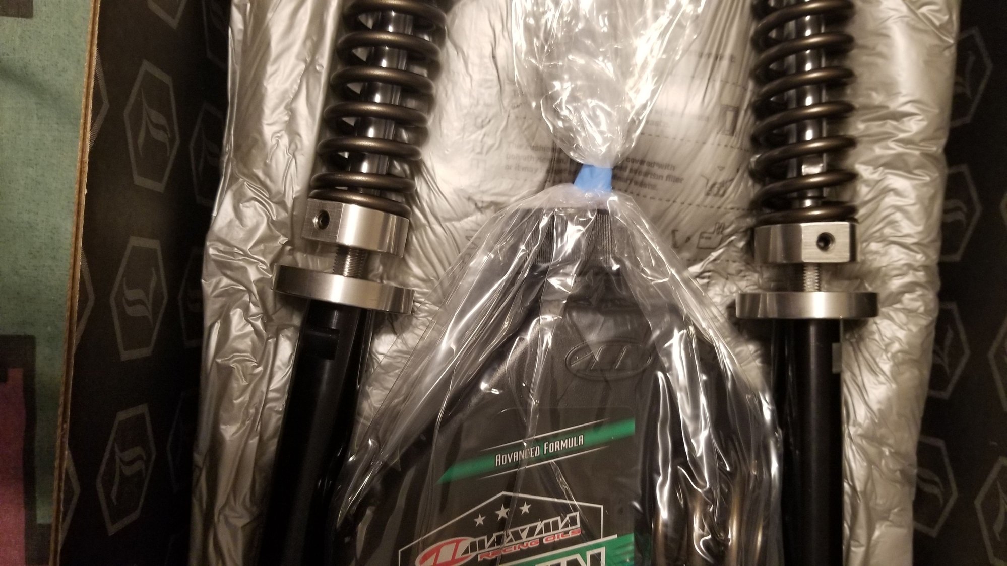

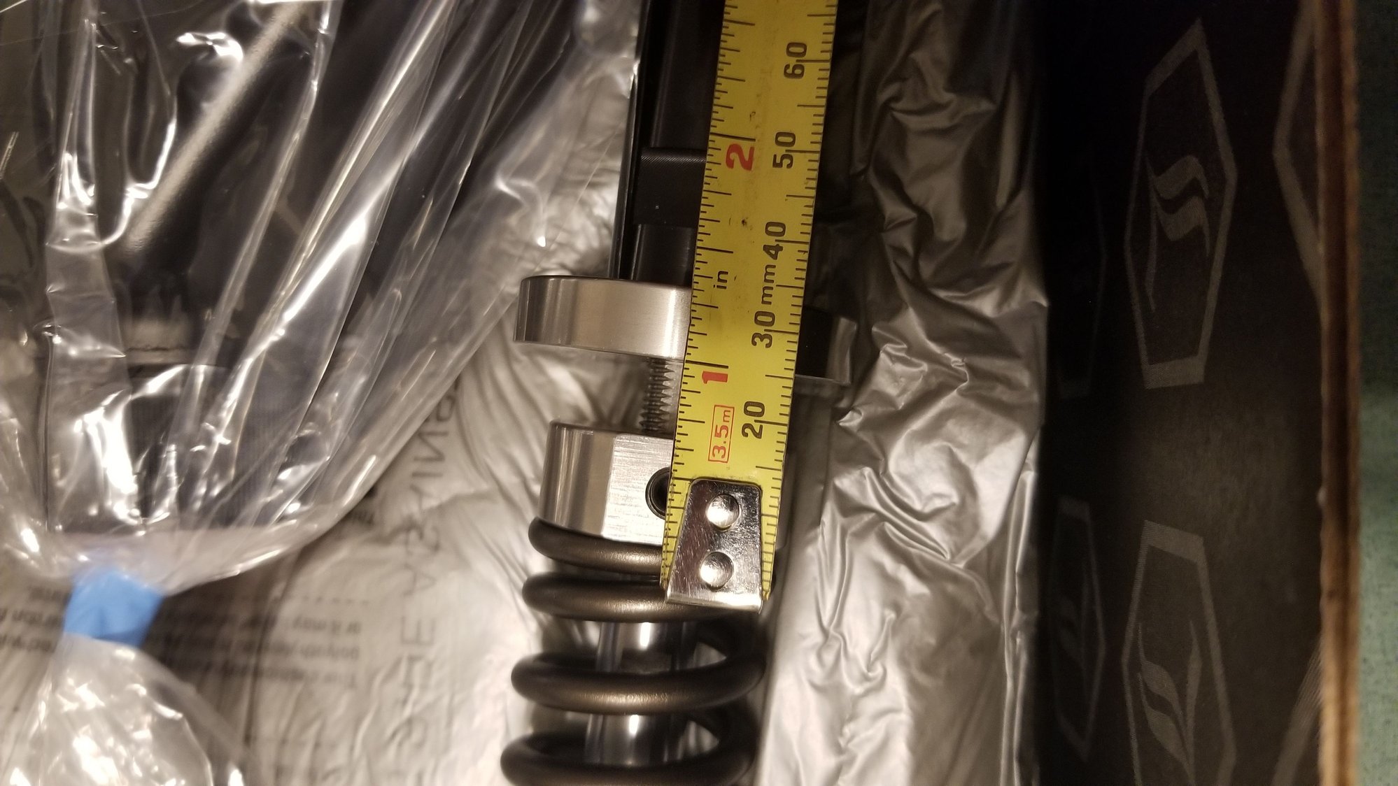

Latest instructions
Settings 1/13/2020 Build Date on Cartridges
0 turns looks like this?
Also I ordered the standard length and they are 27.5" long.
Old Feb 10, 2020 | 07:52 PM
timbo141's Avatar
timbo141
Posts: 1,421
Likes: 277
The question I have about the zero setting in the picture above was answered by Jared at Legend:
"That is the 0 setting for those cartridges. One thing you could check to double make sure is to loosen the set screw and back the adjuster off and then readjust until it is just touching the spring with no tension. This would also be the 0 setting, or wigglethe spring side to side. If it is hard to move side to side or if it is very loose, I would recommend resetting the adjuster.
With all of that being said, they do come from factory on setting 0."
And yes the adjuster is barely touching the spring.
In case anyone in the future has the same question as me, there is your answer.
