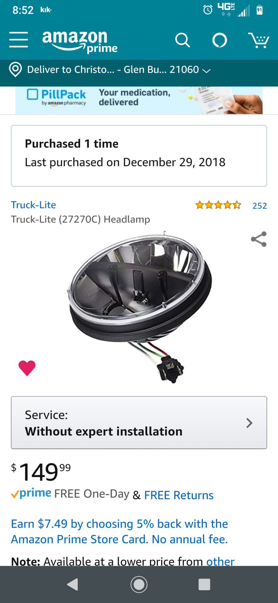

I have the trucklite and matching passing lamps...... Here's just a headlight on Amazon

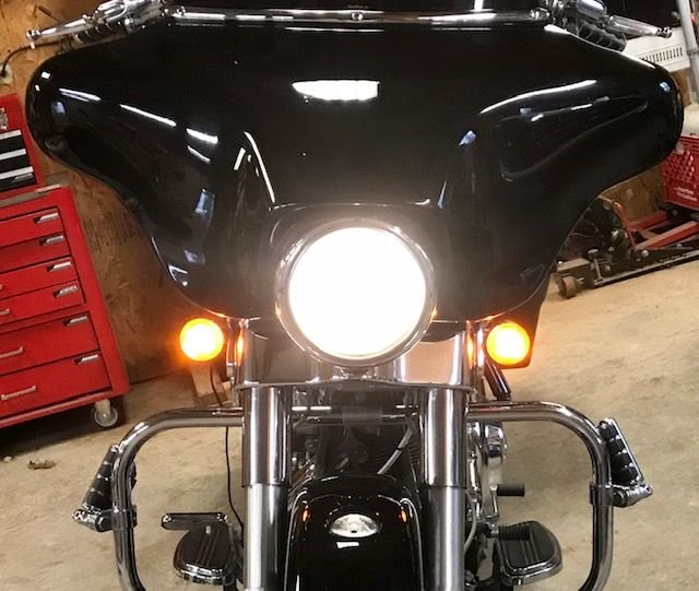

Thanks guys. Truck-Lite Phase 7 installed. Removed trim ring, 3 screws on bracket, switched out headlight, easy peasey.
I did have some trouble with putting the trim ring back on- the clip on the top of the ring doesn't want to stay. The screw on the bottom holds the trim ring on, but it's loose at the top. May have to play with it some more - wonder if the bulb being slightly deeper (sticks out a little further) than stock has anything to do with it. Anybody else have a problem with the factory trim ring?
Pics...

Yep. Factory ring isn't deep enough for the 7. Frenched ring from HD works well though.

Looking good man! I didn't have a problem with mine and the trim ring. Not sure why you do. Just wait until you ride at night. Whole world of difference.
