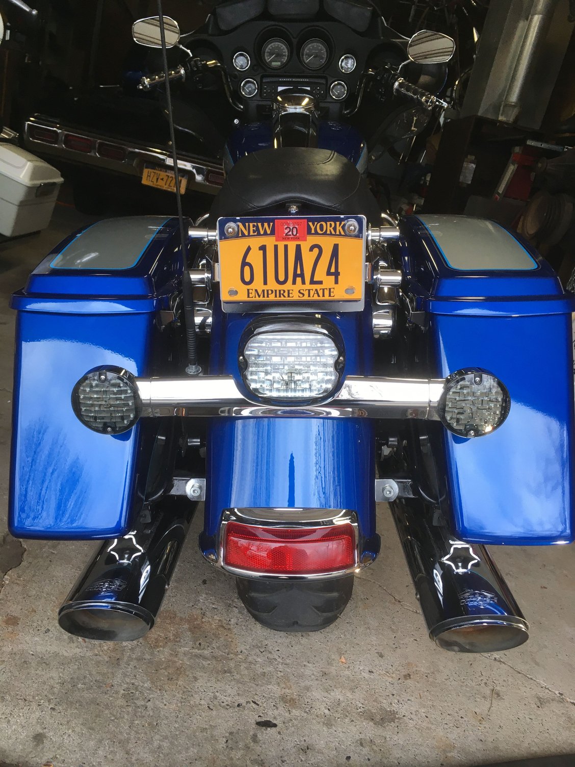

Finished this today, 2010 ElectraGlide Classic, I used a newer Road King light bar with factory license plate light and plate holder. Added bonus it's 2" narrower.

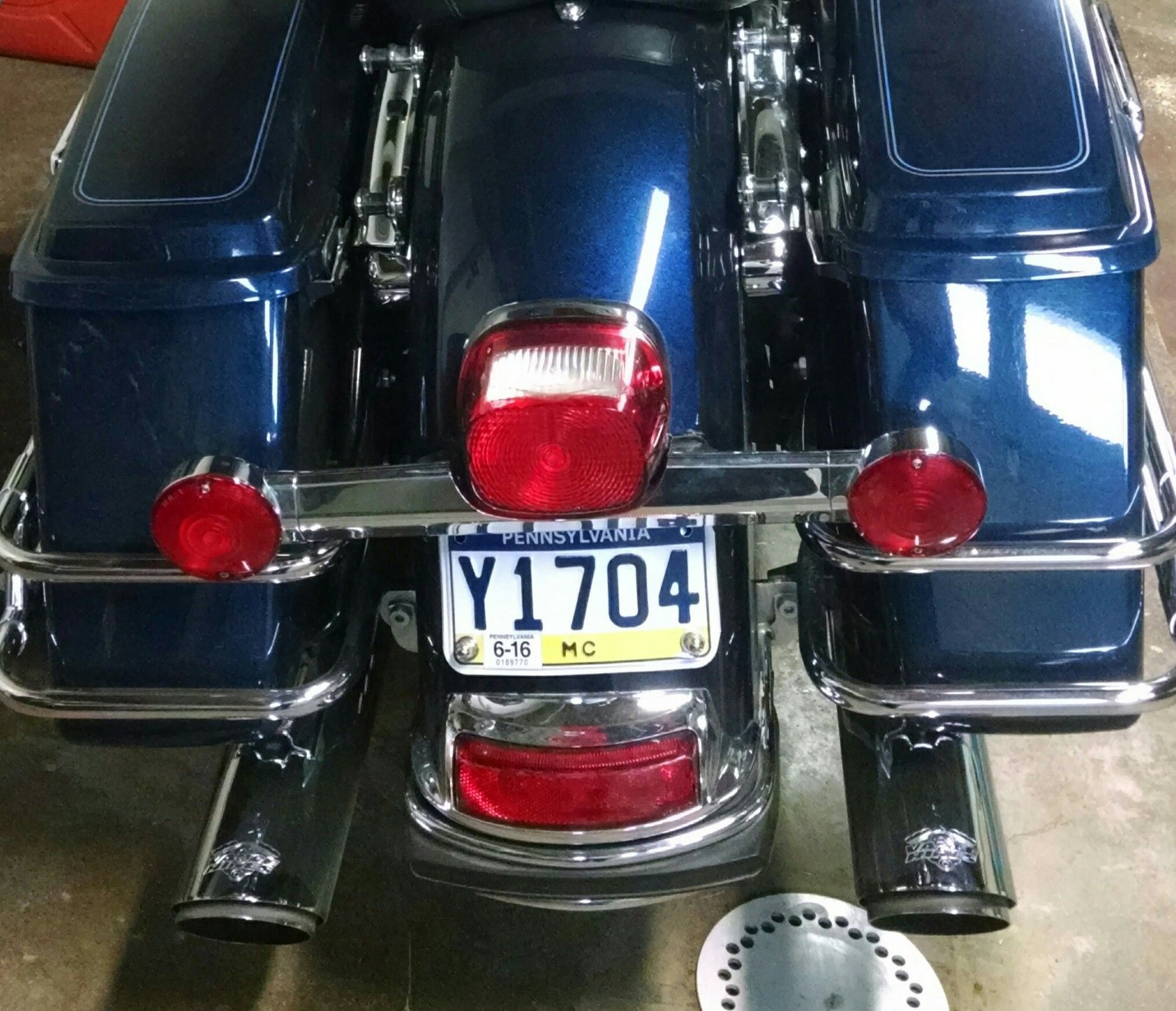

Another option is the signal bar from an 09 Road King or EG Standard.They are similar to your stock signal bar but have the mount and light for the tag below.

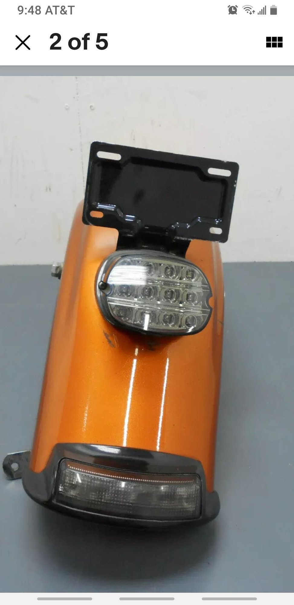

I just picked this up off of ebay for $100. Looks like a newer Ultra fender.
Wanted the smoked lights, plate was a bonus!!!
