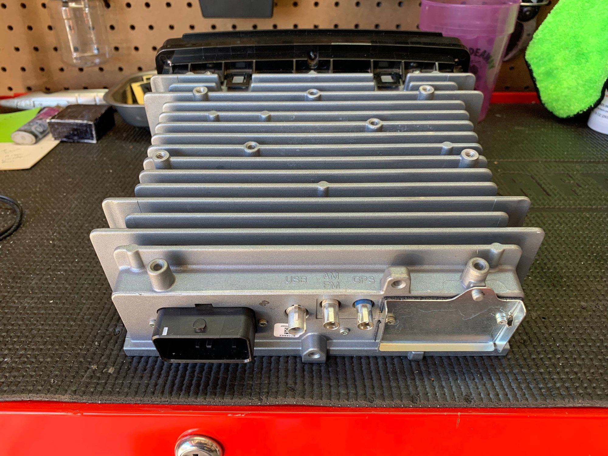

Should just plug right in. Is the one you’re getting a Boom GT6.5 w/Nav? If so it should come with the puck for the GPS. What’s in it now, the smaller stereo? I have one for sale in the classifieds here also, out of a 2016 Road Glide Ultra. Check the bracket on your current stereo, see if it’ll work on the new one, if so move it over to the new one, it bolts on top and the fairing’s top vent snaps down into it. I think theres 4 screws on that and 4 more hold the stereo in and it lifts right out. Put the new one in... Then plug your am/fm, cb, Sirius, gps antennas all plug in, plug the usb cable in plus the big cam-lock connector and you’re done. On the Road Glides it’s a piece of cake. You may/probably will still have to take it to a dealer to have it programmed on their DigitalTech for your bike, takes 15-20 minutes. Here’s the back of the stereo, if you’re getting a Boom6.5, not much difference if you’re getting a GTS, just with it H-D says you need to update your usb cable, but I didn’t.
