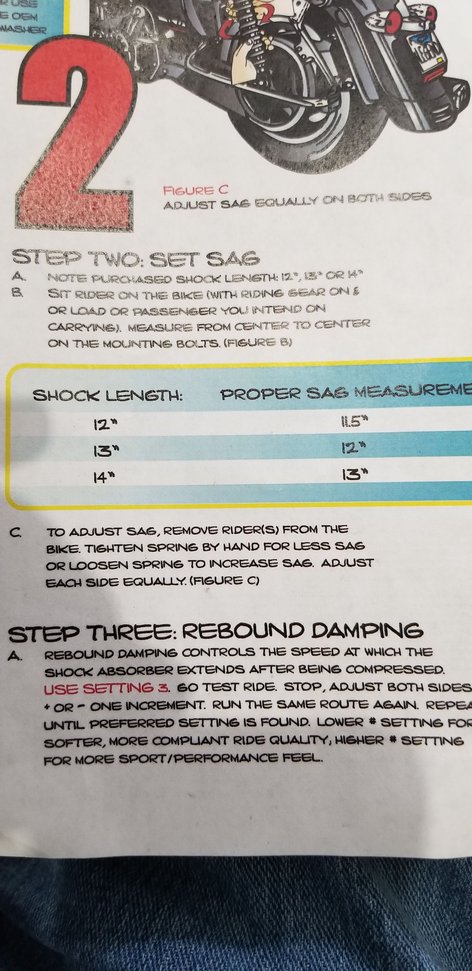

On my SG the stock shocks were 12 in. And there was no sad with the stock shocks . With the Legends at 13, once I sit on the bike they sit at 12, same as stock. The bike sits 1/2 inch higher then stock without anyone on it.

Wrong instructions on the Axeo... here is the updated instructions and although you do fall into number 1 it's 250 to 349 Rider Plus running gear.
The axeos Do Run firmer than stock so zero might be a good setting for you to if you feel 1 is too stiff
