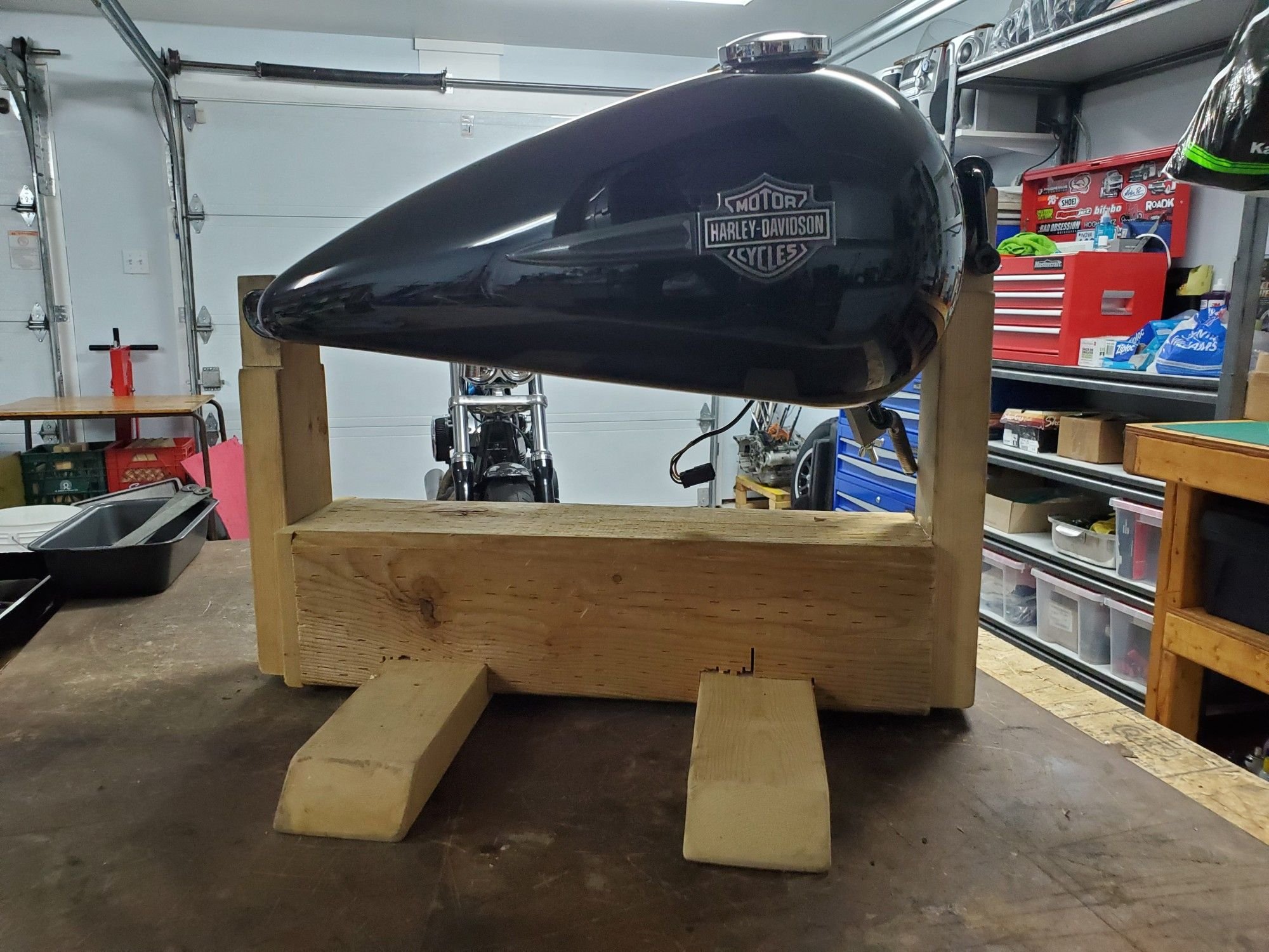

Well, that was unexpected and I learned something out of this one. I was going to say how my post about the tank stand was a bit out of place in this thread, but now it's even more so. I had that stuff on my mind for a while, and looking back it's not really relevant.
I had originally made it to polish the tank and found it useful to keep using. Any time the tank comes off it goes on there immediately, not on the floor or the bench. But yeah you don't have to take the tank off to do any internal work that I can think of, and I should have said so. Here's a picture of it.
Wooden Fuel Tank Stand - Dyna
