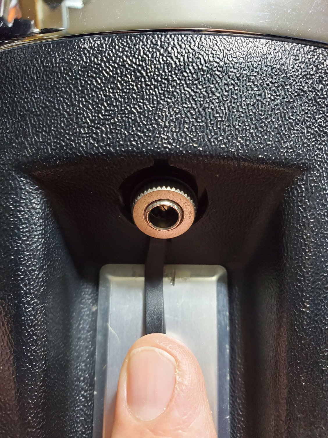

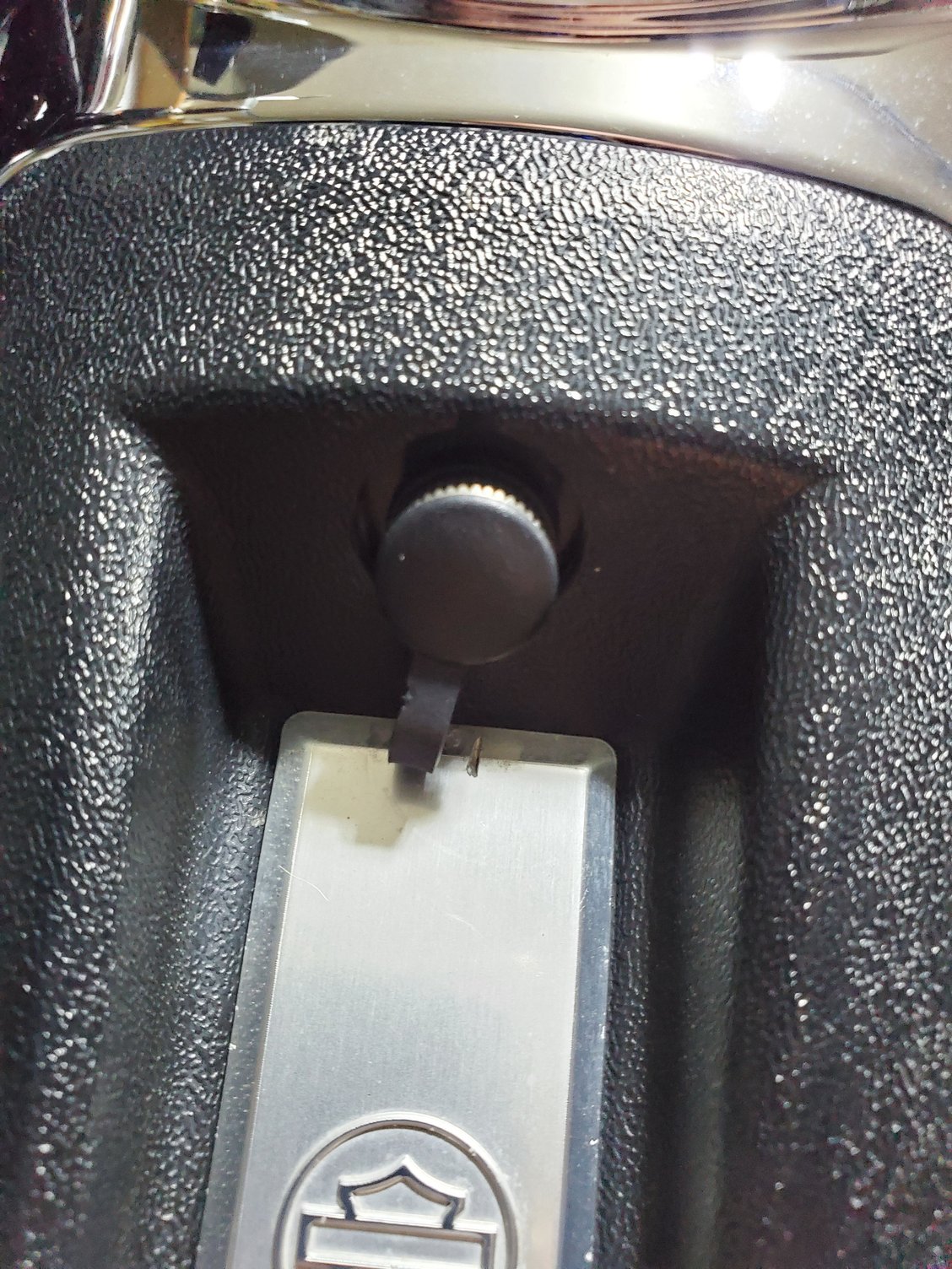

I used this from Gerbing. It's not perfectly flush but it been there for 7 years and it's better than the heated gear plug hanging from under the seat.
Some people use this panel mount attached to the heat deflector.

I like that, that is where the heated gear plug should be.
