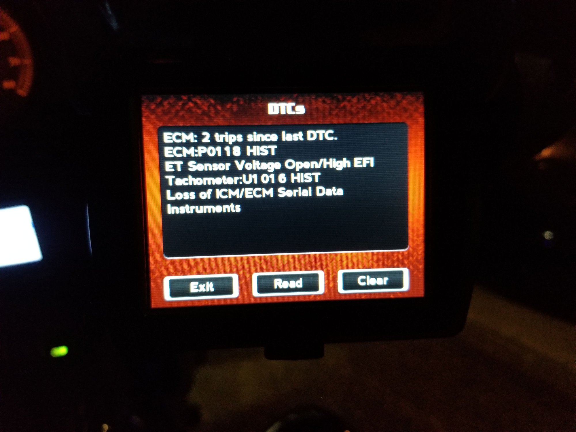

P0505 - I would have a look at your IAC and make sure your connections to it are good and clean . Get yourself some throttle body cleaner and place a rag inside the throttle body and spray it out really well , they are known to get gummed up . Ignition on will cycle the IAC , you can test it for functionality .

While P0505 kinda indicates an IAC problem and its worth cleaning the IAC, I suspect that the loss to speedo sensor might be whats casing that error as it can effect idle.

Originally Posted by Hoffa80
I have a 2003 Electra Glide and it stops when it get hot, but only on low rpm. When I pull the clutch and the rpm goes down it stops. Also the instruments go black but it fires normal again and starts running normal for a little while. It doesn’t stop when I’m driving, but the engine lamp shows sometimes. I have changed the 40amp auto fuse to a normal fuse, but it didn’t help. I measure approx 14V on the battery on 1000rpm. Anyone with experience on this problem? Maybe the ET sensor on the engine? Just guessing. Efi system.
Jimmy
when I had these symptoms about 4 weeks ago it was the ET sensor.

I would suspect your Idle Speed Control motor. P0505 is loss of Idle Speed Control. Then in the diagnostic readout, the second picture look at the steps for the ISC. They are at 72. Proper values are between 20 and 50. Did the Harley shop that ran that diagnostic say anything to you about the readings?
Hello.
No they didn’t say anything. I will check it out when I come back from holiday. Thank you for feedback.
