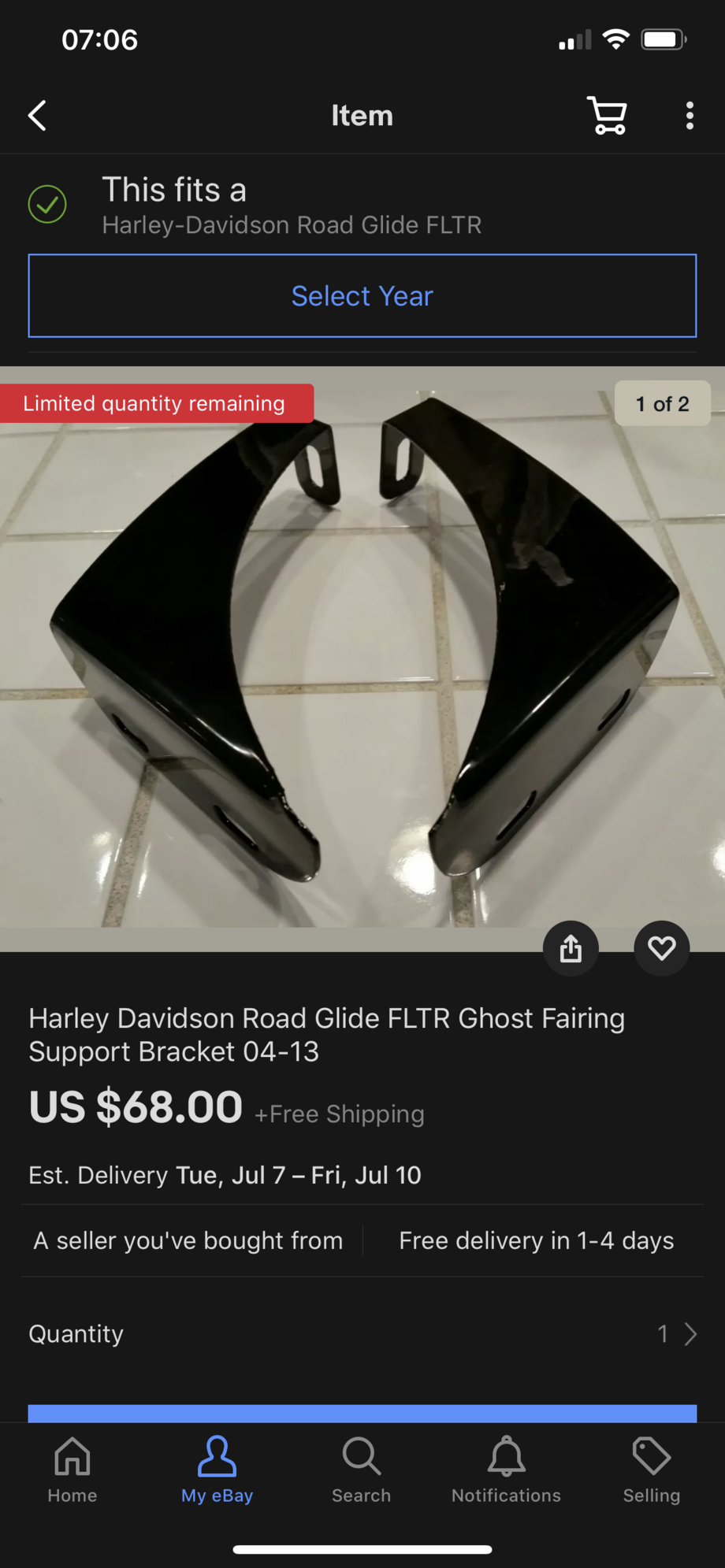

search ghost brackets on eBay. I use ones from m3talworkslv, worked great!

@Kazu Hiro Thanks. No issues with faring bouncing at highway speeds? You were also able to bolt sig lights on normally? I am leaning this way so I won't have to buy crash bar...at least right now.

no bouncing and I’ve taken it up to around 90mph. The turn signals mount fine. I had to bend my bracket a little to link it up because my inner fairing bracket is slightly off because of a crash. They come with lock washer and hex nuts because the stock studs will be too long for the acorns. The oem bracket is pretty thick and these are thin. Again. Surprisingly no bouncing at highway speeds on shitty Hawaii freeways and roads.
