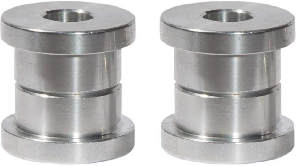

The stock bushing are rubber and ribbed, while there are poly, and even solid bushings as well.
Hence the higher the ape hangers, the more leverage you have to flex the bushing via the bars.
So it may not be that the stock rubber bushing are worn out, but it's just you now have move leverage to flex the stock bushing instead.
So on that note, you can pick up a set of poly bushing for under $10 to give them a try, but if you still finding the bars have too much movement due to the long ape hangers leverage, then either buy or have someone make you a set of solid bushings isntead.

As stated , I would always go with poly bushings when converting to ape hangers . If they are 14's or 16's , I would also recommend a handle bar clamp with set screws that will help prevent them from slipping forwards or backwards .

I got these and they seem okay. Did have to drive out sleeves to reuse them and washers as well--some other kits appear to include those parts if that matters.
https://hillcountrycustomcycles.com/...n-touring.html
