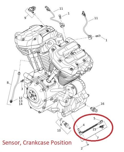

Okay...nobody got anything. So I went to the dealer and they were nice enough to print off the M1517 Service Bulletin for me.
Lucky for you guys I scanned it in so all can take a read.
It looks like the new sensor gets a new P/N along with a creme/white color housing instead of black. There is no mention in the SB in regards to any fault codes--such as P0374 of the suspected original CKP, but I think to use the new updated part instead of the old one. The wording is a little funky in comparison to touring and softail models in terms of what sensor to use. At any rate, the sensor is located at the front-bottom of the bike with an awesome two-pin Deutsch connector that's easy to disconnect. Since the signal generated from the sensor is sinusoidal/square-wave, the wires need to be a twisted pair in order to avoid any interference on either leg.
CKP -- Sensor, Crankcase Position

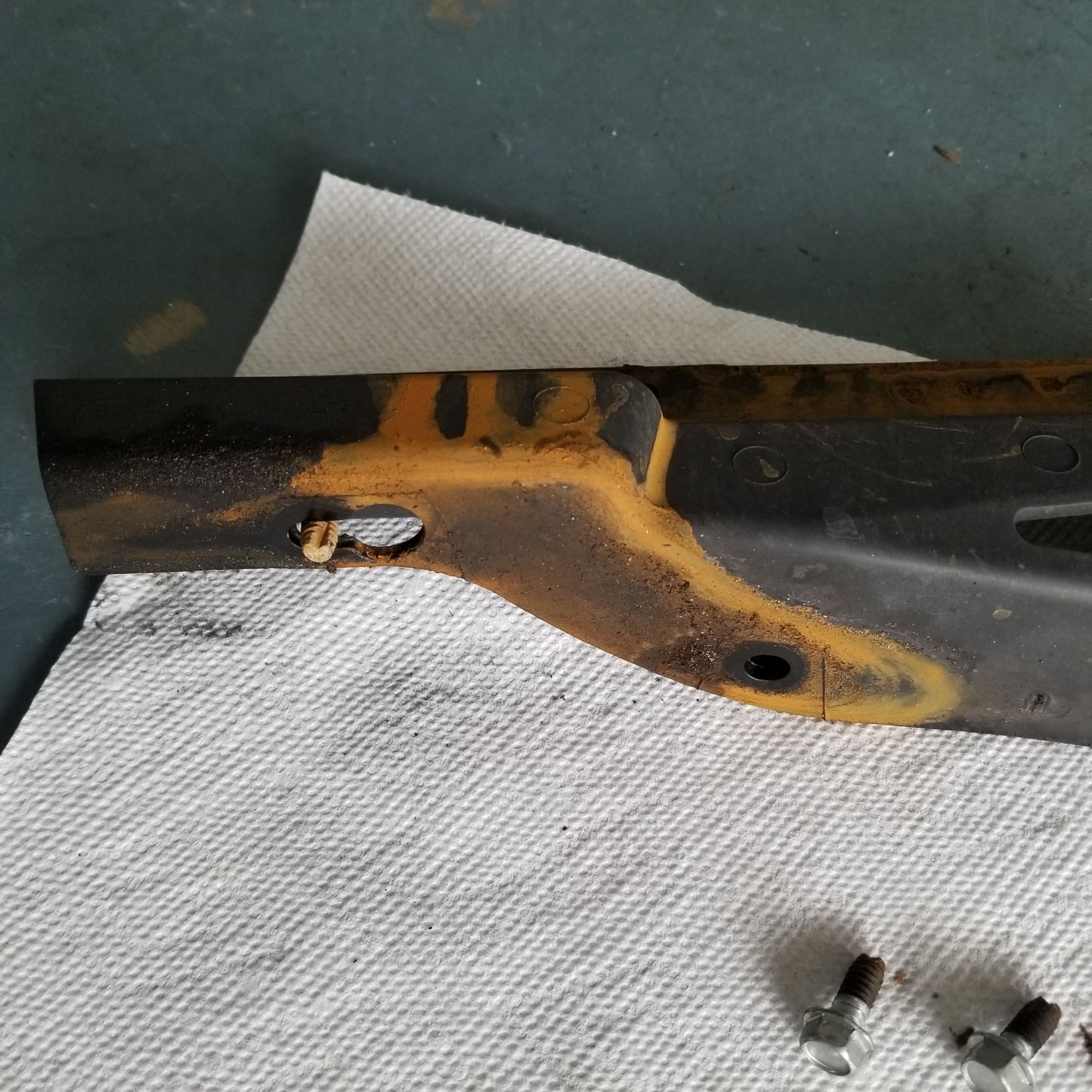

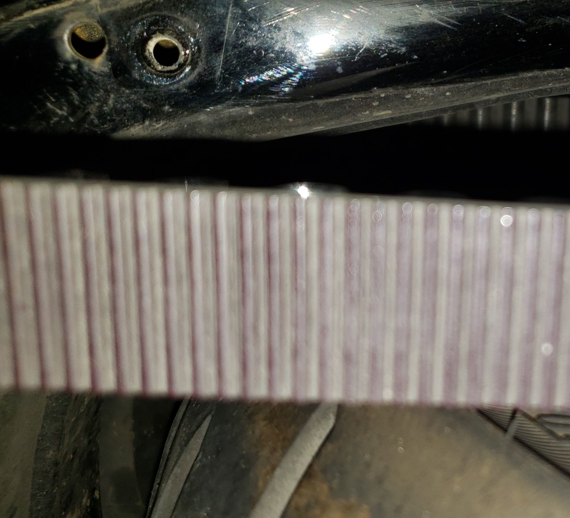

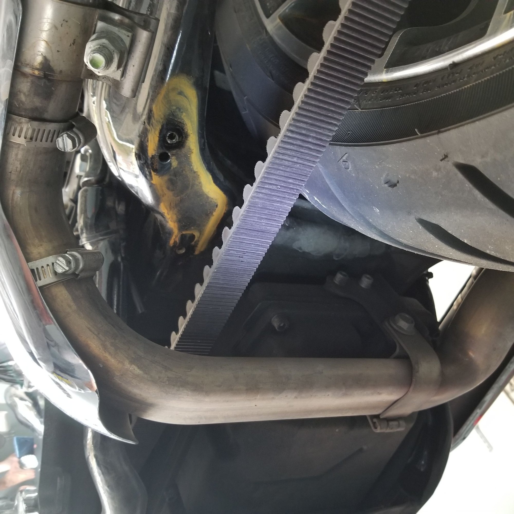

Rusty water in swing arm. Basically the drain hole in the swing arm is covered by the plastic belt guard - should be a hole in the plastic belt guard, but there isnt. It is a relatively easy fix, but... since it is under warranty and they have not updated the belt guard mold since 2009.
Great pictures ... Been there and done that a few years ago ... and I love the comment in the bulletin "This is a cosmetic concern and not an indication of an internal issue"

Now that I read this thread I remember doing this on my 2010 street glide.
after reading this this morning I just went and did my 2014 Street Glide. You can see the outline of the drain hole on the plastic cover.
