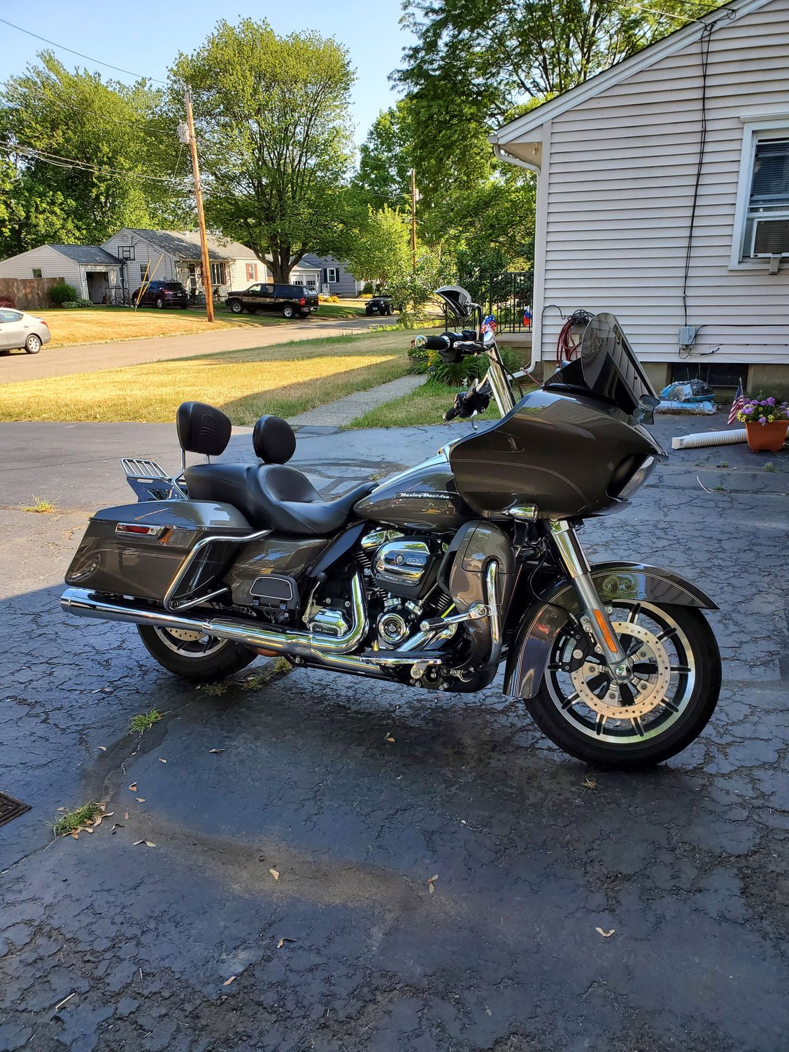

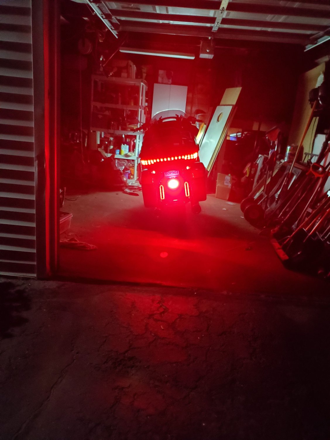

I have a 2018 Roadglide Ultra with a detachable tourpack. when I remove the tourpack or disconnect the lights for it, the blinkers flash very fast. Like when you have a light out. All the lights are working. I do get error code for Tailight out.
What can I do to remedy this problem? all the rear lights are LED
