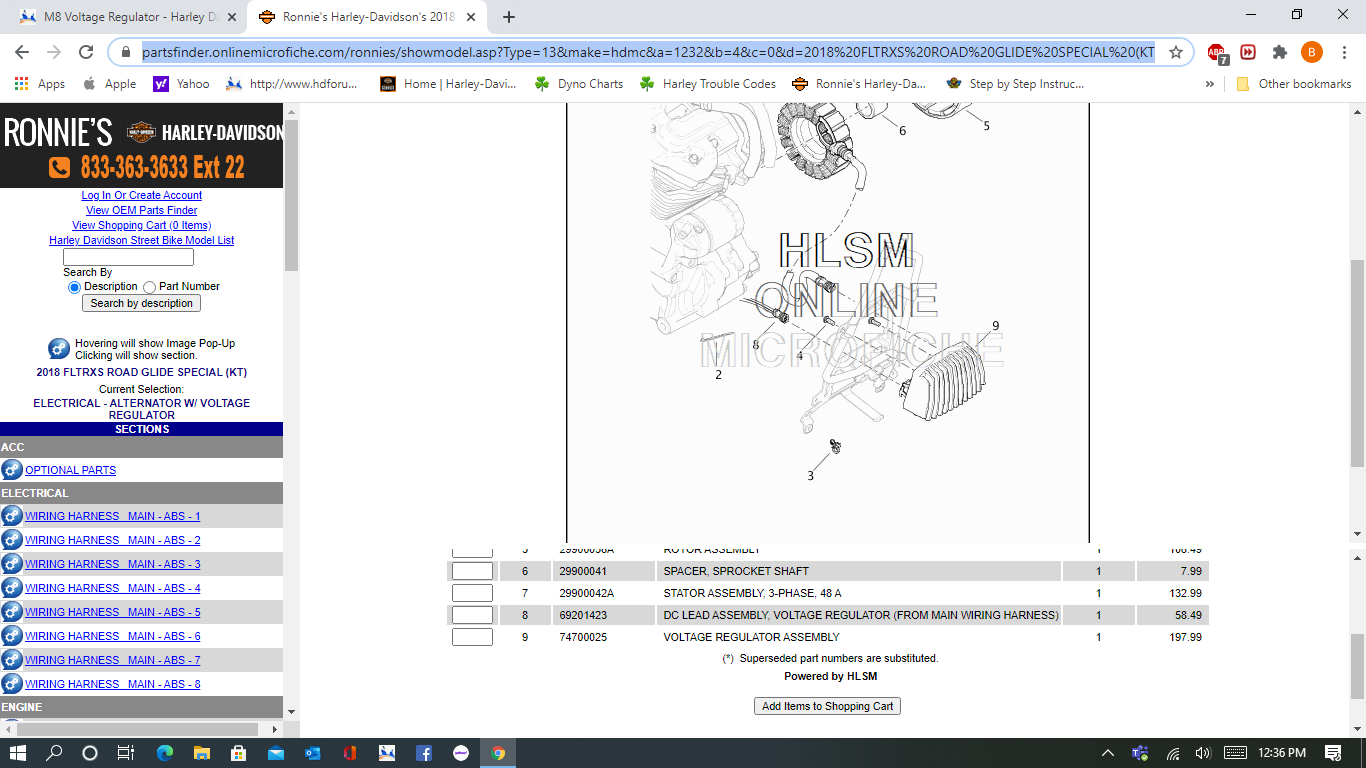

My 2018 RGS with only 1500 miles on it seems to have the voltage regulator crapping out....15.5-16 volts on my home today (in the red)
Of course, warranty just expired....anyway, HD websites are showing a voltage regulator for 2015 and down??....does anyone have the correct part number for my 2018?

This link will help you find part numbers
http://partsfinder.onlinemicrofiche.....asp?make=hdmc

thank you for that. Ordered, replaced, and back to 14.5 volts.
