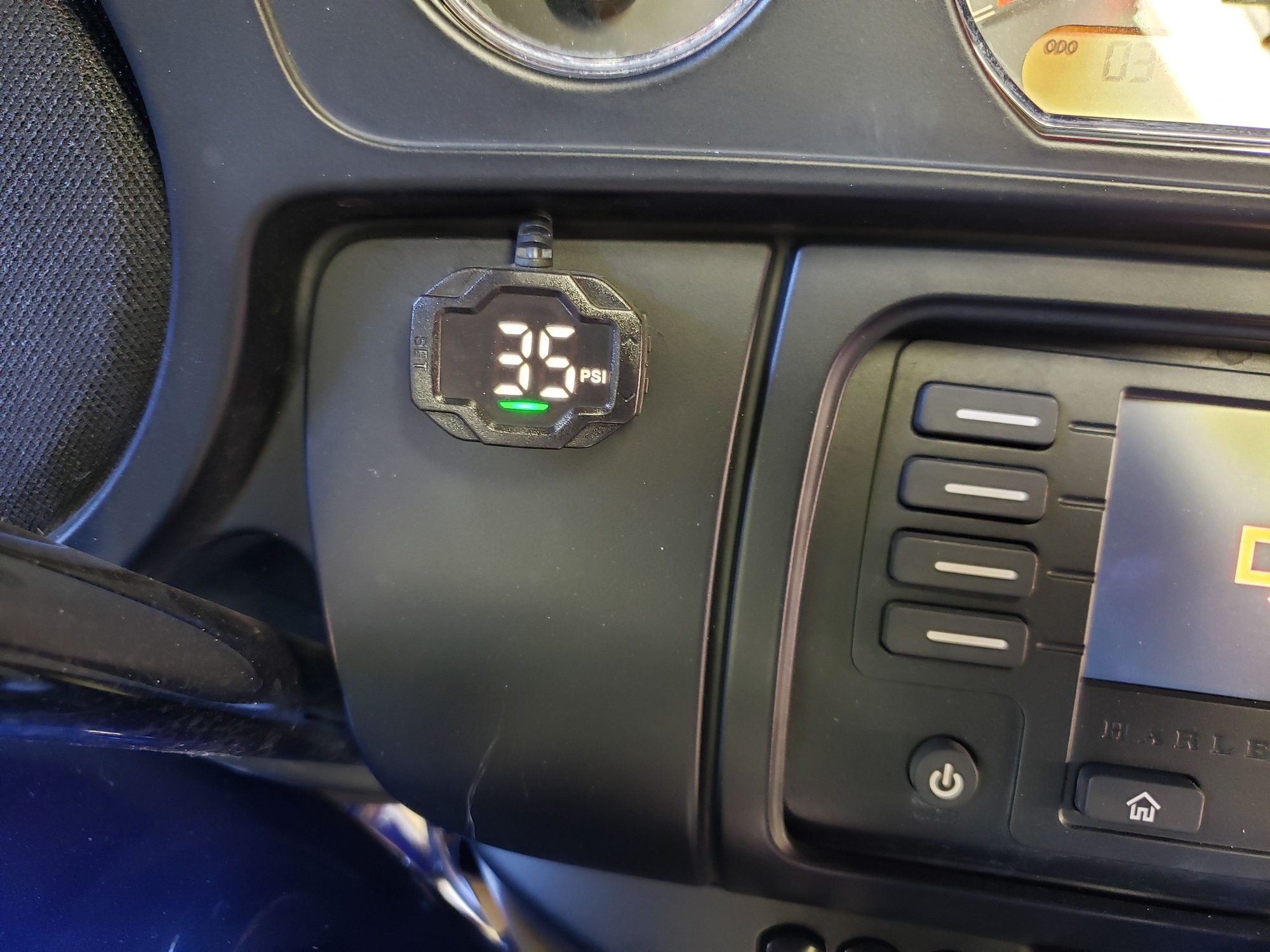

Ahh...the "17 and newer" is probably the difference as I was looking back in 2016 when I bought mine (wow...doesn't seem like that long long ago).
But mine isn't FOBO, it's Steelmate.
Amazon Amazon
I completely agree that notifying a phone that's probably in my pocket isn't nearly "in your face" enough. This has display that can either be mounted to a handle bar or flat mounted on the dash. Below is what it looks like on my dash. The green bar toggles from top to bottom to indicate front/rear respectively. The bar will turn red, flash, and sound an audible alarm if it goes outside of a programmable range. I also like that It's hardwired to the bike so it comes on with the ignition. I had read reviews somewhere and they indicated this was one of the better ones for motorcycles. And at $60...I think it's a pretty good deal. There are some that you actually have to replace the entire sensor when the battery dies. These use a replaceable watch battery that lasts about a year from my experience. It will complain when the battery gets low. I should probably also mention that I had to buy the "T" valve separately.

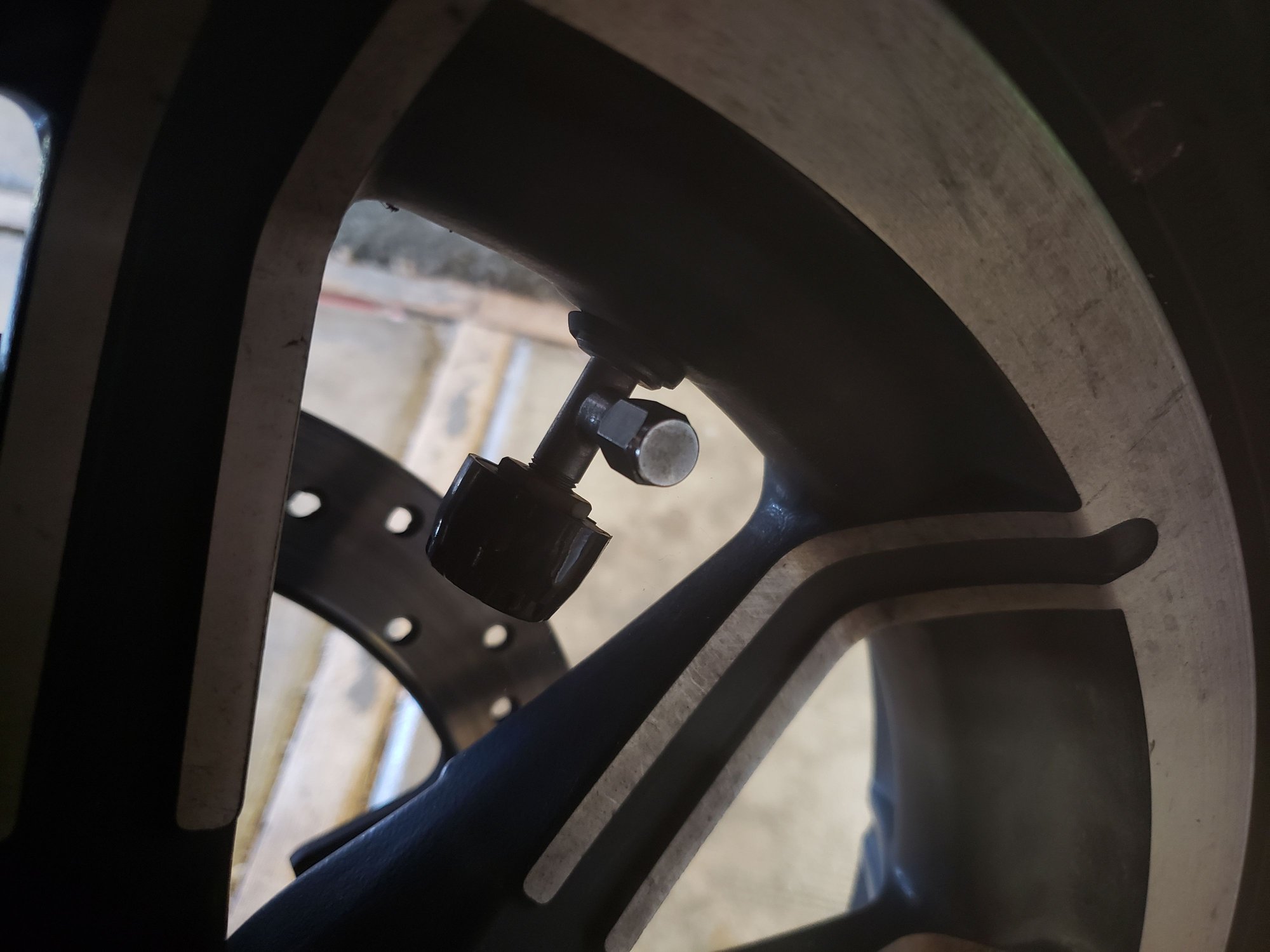

I always wondered why more people don't go this route. I can add air without removing the TPMS sensor. My TPMS isn't FOBO, but same principle.
Details?
I assume you had the tires rebalanced when those were added? Is that valve stem installed from the inside? What brand and where did you get the stems? Thanks.

Yes, I had the stems installed with a tire change. I did have them specifically write in the work order to have the sensors on when they did the balance. I can't imagine they would do the balance then replace the stem. But even if they forgot to put the sensors on before the balance, I read somewhere that the sensor weighs less than 10 grams so I doubt it makes much difference.
And I forgot where I ordered the "T" stems from, but someone else provided a link.
The one item I would mention for any of the valve stem mounted sensors...make sure they are fully seated onto the stem. They have a nub inside that has to open the valve in order to read the pressure. When the shop put them on, they just put them on until they felt tight and called it good. I don't recall the exact amount, but the instructions say you have to tighten it another half turn or something like that to get the nub to open the valve. If it doesn't open the valve...then it's not really getting the tire pressure.

Any issues with leaks at the valve?

Can't speak for others, but I've had no issues.

Somehow I missed this picture before. I love that style. Looking at the link, did you cut a hole to mount the display? The display in the link looks too deep for a surface mount.
