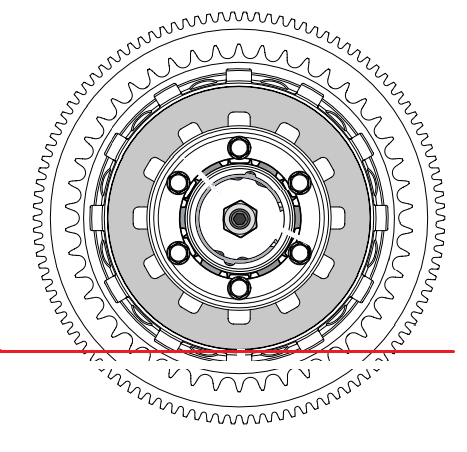

Stop obsessing about the quantities listed in the service manual, and simply set the level visually, after all, if you don`t know what the level should be, how would you check it if you were on the road and suspected a leak?
Stand the bike up straight, fill the primary until the lube just touches the outside diameter of the clutch shell.
This is the correct level for every big twin since mid `84.
If you need to know how many ounces it takes, just keep track of how many ounces you use the first time you set the level and then you will know.
The service manual quantities will drive you nuts, if I followed the quantities listed in the service manual for my `89 Softail, I would have oil all over the garage floor from overfilling the oil tank, and my primary would be full right up to the derby cover opening...
Don`t take the quantities shown as anything more than giving you an idea of how much oil you should have on hand...
Correct primary lube level, bike vertical.
